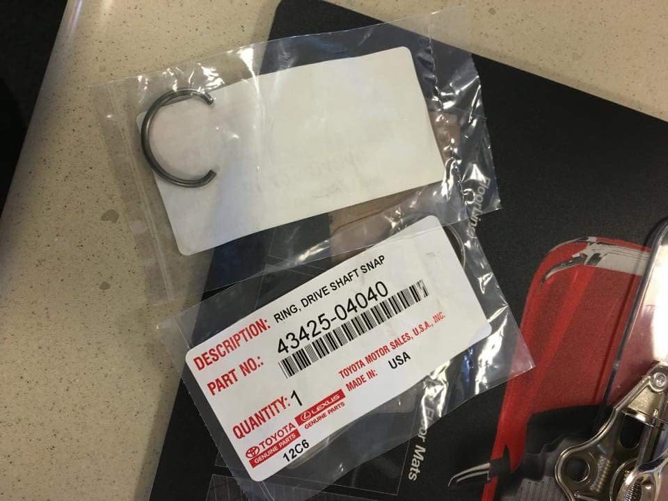

    @tacomgee and everyone...
    When you did your cv swap did you replace the snap ring on the birfield joint side? Pn? Mine looks katywhompus
    Also looking for Pn on the little tin dust shield for the diff side. Found the spindle side Pn.

    Maybe this one?

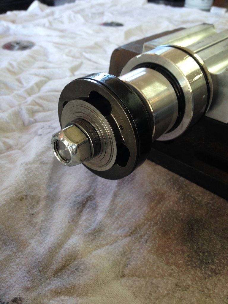

    Need help. Revalved my shocks to fox chart COMP #120. Now the stover nut doesn't Thread on all the way to lock properlyIMG_4580.jpg

    Remove the washer that is riding on the nut.

    Figured it was that but didn't want to put it together and find out that was a no no haha. Thanks for watching out

    You have 2 washers under the stover nut, I've always used one. If you're not in a rush, why not use a new stover nut?
