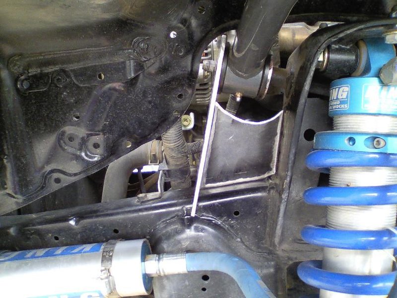

    Then takes notes for me please. I'm doing the DMZ kit soon. Been working on bed cage mostly.

    @Radarninja which coil bucket gussett brand is that? I have TC ones to get in, along with alignment tabs and dmz engine reinforcements. Hoping mine aren't as much trouble.

    TC and TC cam gussets but haven't put those on yet.

    Dmz motor mount reinforcements? Or something else?
    I did the dmz motor mount gussets already its wasn't bad at all.

    I've welded coil bucket gussets on for a few people. Part of the issue with the shitty fitment is the pre-bent gussets. The coil buckets move, the reason for needing gussets in the first place. Pre-bent gussets were prototyped on someone else's Tacoma, with a coil bucket in a different position.
    I'm designing my own gussets that aren't pre-bent and allow you to position everything without big gaps.

    My Solo Motorsports gussets came as all separate pieces and I only had to grind one small part where it overlapped that weld on the frame that everyone has fit issues with. Remember to use some thin washers on either side of the UCA when you mock it up and weld the inside edges first then the outside edges last so it pulls the gap open a bit.

    Yup, that's what I meant. Did you have to disconnect the steering shaft for the driver side?

    Yea I disconnect it and then my wheel was aiming to the left. When I "fixed" it, it was to the right. Third time was a charm lol
