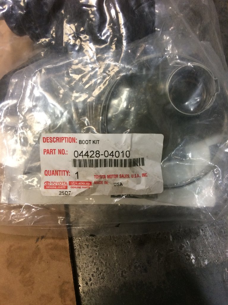

    After looking close that looks like the on that goes into the diff. No matter though the ring I need came in this.
