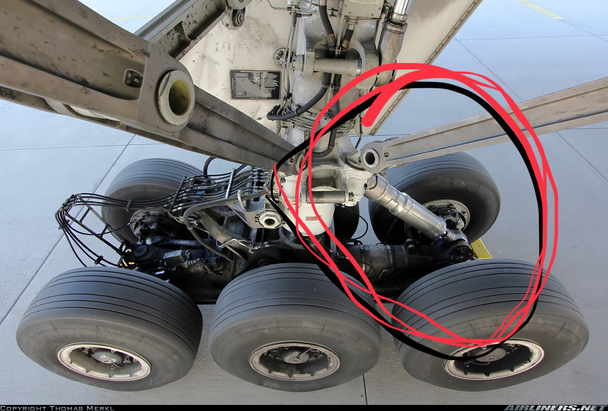

    This guy circled, is 5’ long when compressed. The rod end itself is a foot long, that’s a big hiem joint!
