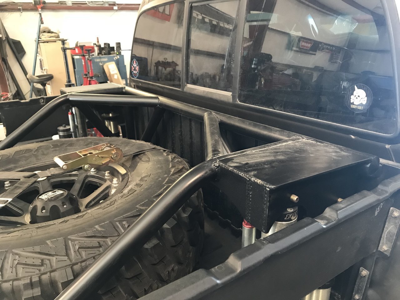

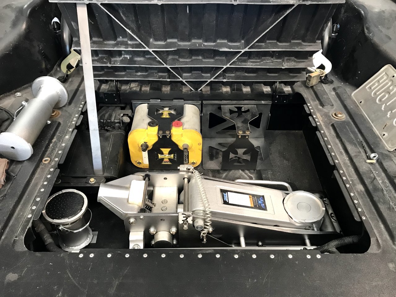

    I really like that bed storage. Is your gas tank still in the stock location?

    Yup, wanted to keep the bed as usable and spacious as possible.
