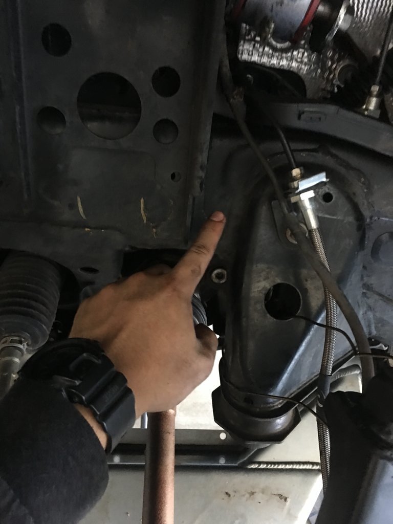

    Anybody install a total chaos +2 or +3.5" kit on a 3rd gen? Looking at welding up limit strap mounts and the space to weld them on a 3rd gen is super tight and hard to weld compared to a 2nd gen. The bumpstops extrusion is way higher on the frame compared to the 2nd gen. Pics for reference. IMG_1854.jpg
    This space is where it says to weld the mount for a 3rd gen. the extruded part where the brake lines and bump stop is on is so much higher on the frame than a 2nd gen. IMG_1855.jpg
    Pretty sure I can't fit a welder there
    Notice the space available here. This is a 2nd gen frame.

    Looks like you could get a welder in from above if you unbolted the brake line bracket..

    No way to weld the front edge though because of the coil bucket..

    can't get it from the top there either?

    The most would be a small tack and maybe a 1/4" bead at most which isn't enough

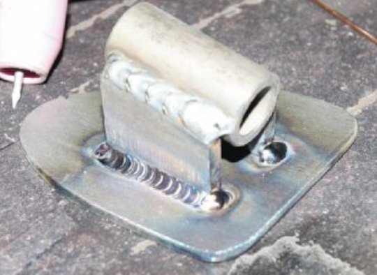

    Any way to cut a piece of steel to fit between the coilbucket and bump. That can sit flat against the frame. Weld the bracket to that piece then weld the flat piece to the truck?
    What I mean is something like this but shaped to fit in your spot.

    That's a great idea! I'll try to see what I can come up with. Thanks for the idea. I did some research on other 3rd gens with the same kit and found 2 pictures with it in that spot so it is possible. Baja kits uses a different mounting tab location on the LCA and angles it towards the rearward section of the frame.

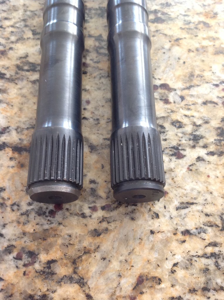

    When you find a great deal on a set you of " brand new never used " axles open them up and see this :frusty::smash:

    Wowwwwwww rip :bananadead:

    Ground down the end of it?

    If a circlip still holds on it run it
