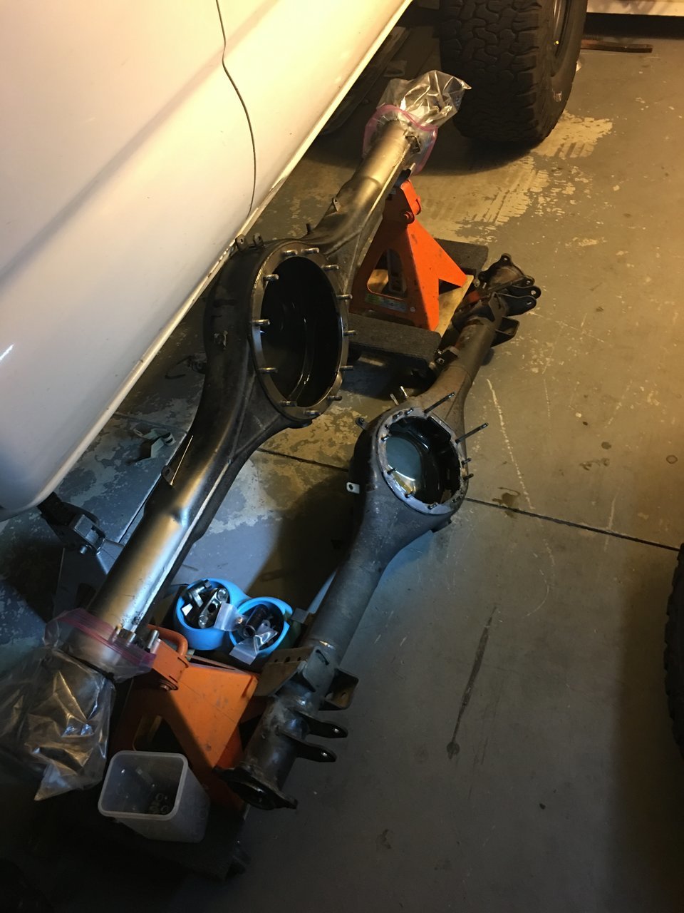

    Anthony and the other DTF guys with Tundra 10.5 axles are still running spacers/wheel adapters to run their 6-lug wheels.

    Expensive and kind of a pain if you do it right. Everybody else I've seen with it is running 5-lug to 6-lug wheel spacer/adapters or different wheels in the back.
