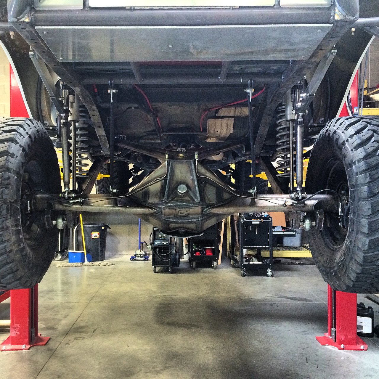

    Look I found an old image of me building my 2nd gen!!!!

    Oh dats'a nice ass!:muscleflexing:
