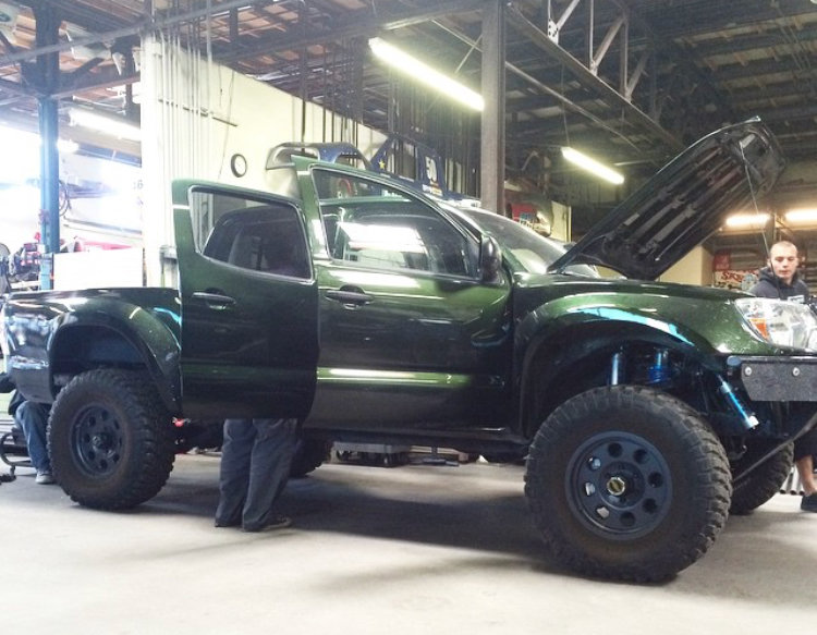

  11. Nov 2, 2017 at 6:55 AM

    There's no hard or fast numbers. That's something you gotta work out on paper when you design your setup. Separation between upper link and lower link mounts on the frame, as well as what position you mount the lower links on your housing will play a roll in that. As well as the amount of anti squat you want built in. 48" is probably the shortest I'd go in the lower links. The setup I designed for my truck (dcsb) will use 51" lower links.
    Your kind of on your own when designing a setup like this. I'd stick to the general guidelines for setting up linked suspension on an off-road truck and setup link lengths around the geometry and suspension characteristics you're shooting for. In order to get exact lengths from someone they will need to give their exact mounting locations as well.
    The best answer I can give you is take it to @jeffz0rz

    I'm not trying to copy anyone's setup.
    What I was really after were some ratios for those who were happy with their 3-link panhard route, specifically on 2nd gens. I have an access cab and the only others here who have gone this route are double cabs, so copying them wouldn't do me any good anyway. Thanks for the advice though.

    The dcsb and aclb will actually be very similar only difference will be shock location and making sure your geometry stays in check thru the extra droop travel gained from the aclb better shock positioning
