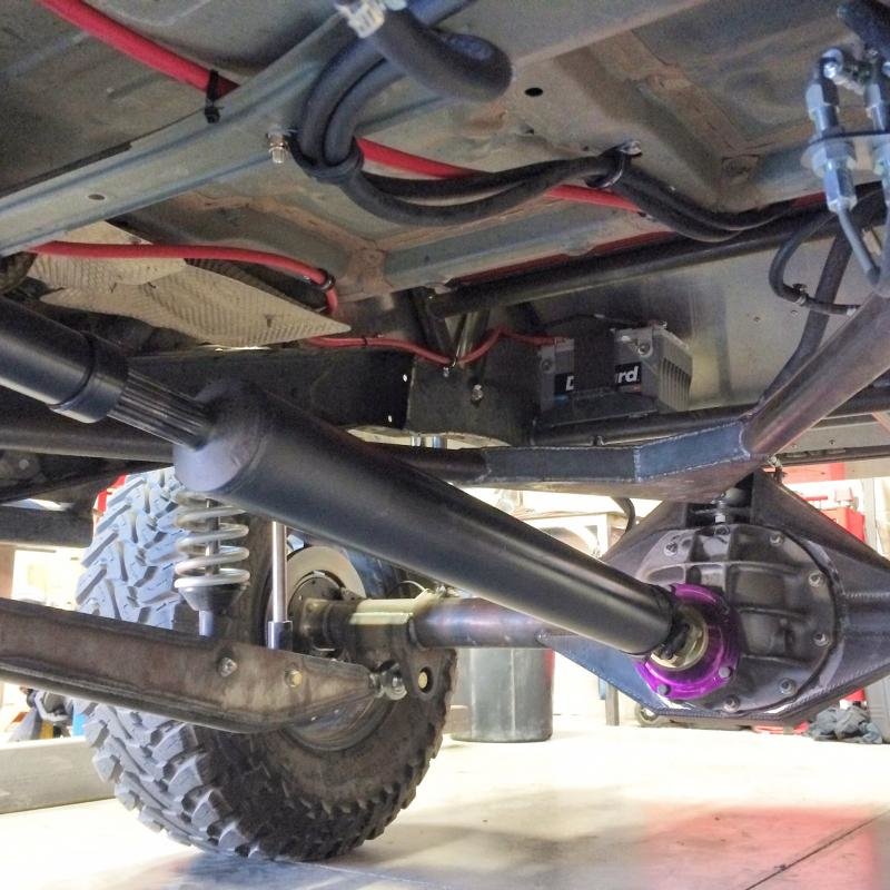

    mines a conventional style wishbone 3 link since I ditched the stock fuel tank so i might not be the best reference. I believe Im 49.5" on the links, stock style 2 piece driveshaft, off hand i cant remember angles.

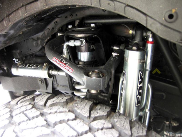

    Just a set of Fox 2.5x8’s triples with a piggyback reservoir

    A wishbone upperlink, personally I think works better than the two seperate uppers on our trucks cause you can't really get the correct "perfect" geometry for em. Less link steer too. I'm building mine to be a wishbone style setup too, along with my Roomies racetruck...

    Yep.... I have the trailing arms all cut out already.... just got to get more parts

    Getting close to starting the reassembly process....out with the old(on the ground) in with the new new

    I had the same problem with clearance to the LCA, regular worm drive clamps were dry humping the LCA badly at droop. Solo advised me to add a 1/4" spacer between the LBJ adapter and the bottom of the spindle and it opens up a ton of clearance. Paul said that they often weld on a spacer in that location during builds but that a loose spacer with the correct size longer bolt is fine.
    Here is a photo from when I was mocking it up with washers to figure out how much of a spacer I needed. You will need to buy 10mm longer grade 10 bolts too. I found 1/4" motor cycle axle spacers online, 10mm longer bolts locally but in black oxide still need to replace with some zinc.
    Note - this will lower your front end 1/4", NBD that's what all those threads on the shock body are for.
