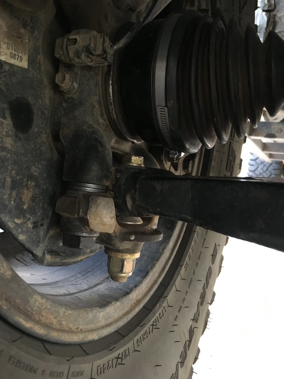

    Thanks man!!! Just did it today after getting my snapped axle rebuilt.
    And after talking to dirt king about this while talking to them about my axle, I sent them pics to show to their designer. I guess their second gen kit (with secondary shock tabs) had a few other minor changes that affected the clearances here. They are now sending their kit with machined spacers and bolts and they're sending me a set as well. Plenty of room at droop now for the hose clamps.

    If you run a traditional style cv clamp it's a non issue. Tc sends a traditional style boot clamp with their axles cause clearance is tight on the race kit

    Yeah this was figured out over the last two weeks with me talking to them. I'd give them a call and see if they would send you some.
    I was running traditional style clamps, but with the machined inner cv's that dirt king does, it allows for more droop than the tc race kit. I was limiting my travel to where the clamp was hitting the lca. After the clamp hitting the lca and popping them off, I wanted to run hose clamps instead. With the spacer there is now plenty of room

    I feel like the benefit of the extra 1/2" of droop is negated by having to run stacked washers in a critical place that normally has two machined surfaces mated together and torqued to spec, but to each their own.

    As @Evenflow stated, solo motorsports does the same when installing some kits. And I am going to swap the washers with machined spacers when they get here. They literally called me to mention the new spacers as I was doing the install tonight
