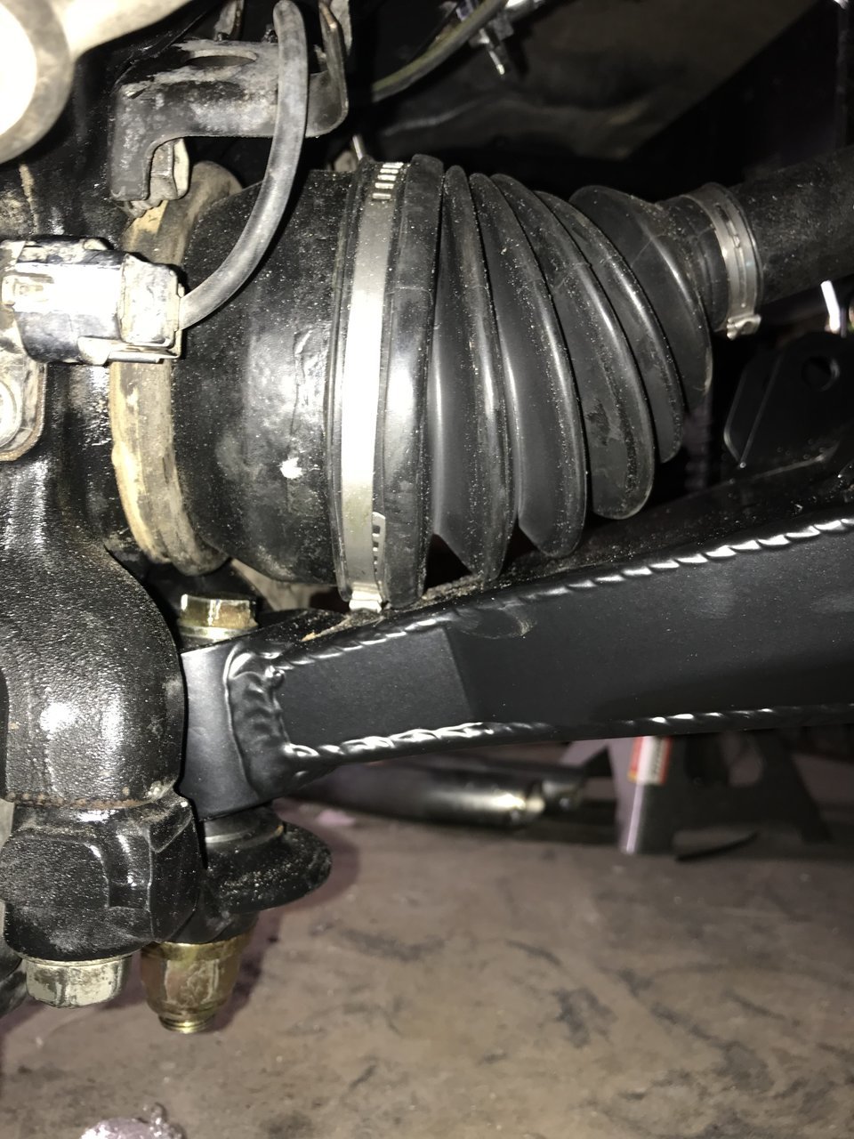

    In my case it was a lot more than a 1/2" of droop gained. The washers are only used to mock up how much of a spacer you need and then you can make or order a solid spacer. Paul at Solo stated that there was no need to weld the spacer to the LBJ adapt when it is only 1/4" and the correct extended length bolt it used.
  2. Nov 16, 2017 at 6:41 PM
    glorifiedwelder
    glorifiedwelder IG= @Liquid_Torch
    Feb 14, 2015
    #148647
    3,658
    jason
    Santa Clarita, ca
    double cab trd sport
    I get that. I'm familiar with the spacers a set came with your oem DK arms. A machined spacer is a long ways off from a few stacked galvanized washers. I'd be willing to bet as many people as would go to the trouble of machining a spacer, twice as many would just run a set of washers. You go above most when it comes to fixing these things right Jason. That's not the norm these days.

    Hey there, I was thinking about having my old boss lathe me out some spacers out of billet since I'll be out near him next month. But if I didn't have that tie I'd probably run just the washers :anonymous: Now gonna run the machined ones dirt king is gonna send me when they get here.
    I like to fix things right, but don't get scared of a bandaid that's not super sketchy. My shit gets checked often enough and I used to be a tech as a profession

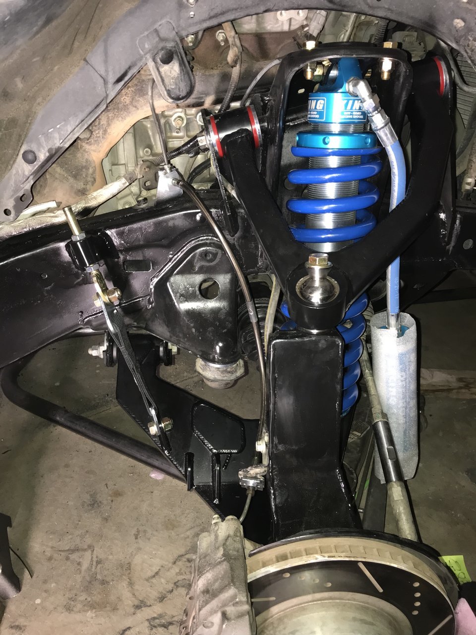

    Ya I’ll be calling Dirt King tomorrow... Time to crank limit straps. No biggie, it will all work itself out. We aren’t talking simple bolt on accessories. These things take tweaking.

    Looks like they need to revise thier lower arm design and put a lil bend in it to fix the issue

    What size bolt are the spindle bolts and how long do they need to be to run the spacers? Just in case I wanna make something work for a couple days.

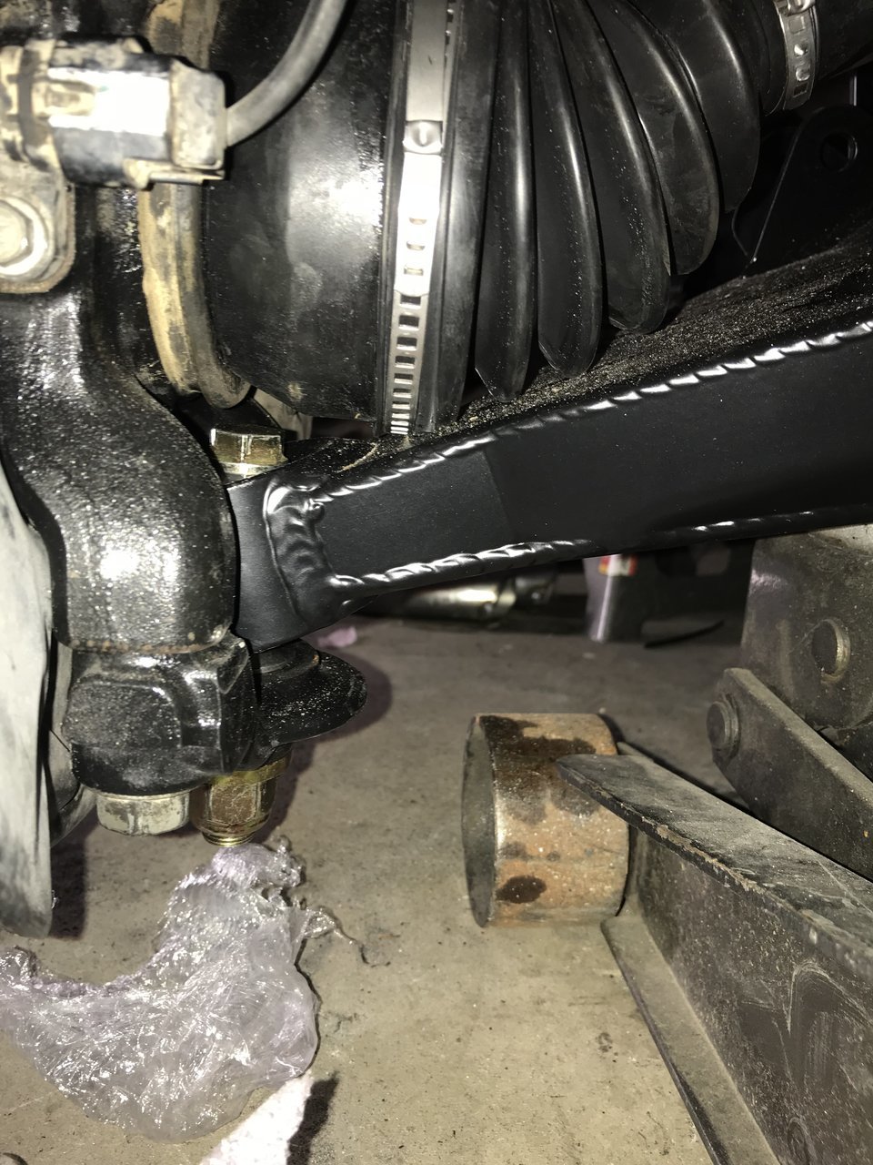

    Even with limit straps cranked...

    Again thanks. I did just that and the pass side was binding, I cranked it back up until I could rotate the tire,(about an inch) Might have to go with 8" straps instead of 10. Appreciate the input man!

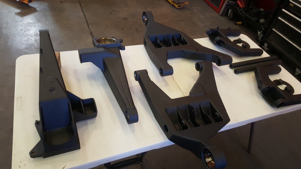

  9. Nov 16, 2017 at 11:43 PM
    DTFtacoma
    DTFtacoma Dezert Toy Fabrication Vendor
    Mar 5, 2009
    #14364
    6,951
    Anthony
    Santa Maria, CA
    06 PreRunner D-cab
    DTF LT front & rear
    I love this powdercoat!

    16x1.5x45 is stock. So I went with 55mm length to allow for the spacers.

    I just gotta say Dirt King has stand up customer service. I emailed Greg a pic last night, he called me this morning first thing. Said they were making parts right away and I should have them in hand tomorrow (good to live close for one day shipping).
    Pretty stand up service for sure!

    also i hope that isn't ride height and why aren't your limit straps set??
