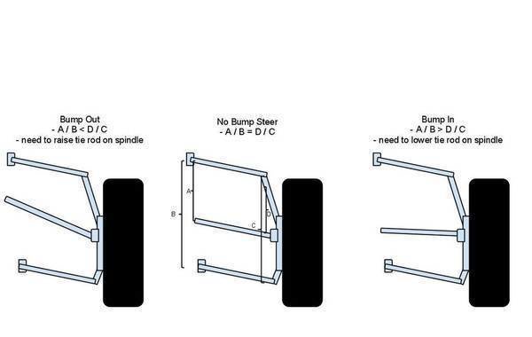

    Is nobody gonna mention the elephant in the room?
    A fabricator designs a kit, which one would assume was designed with geometry and bump steer in mind. And then said kit has issues with cv boot fins rubbing the LCA. So the fix is to add spacers to clear the fins. But what happens to the geometry? You have effectively increased the one variable without compensating for another. So was the kit designed correctly to start with, and the spacers throw it off while fixing the boot issue and fucking up bump steer? Or was it designed incorrectly, and the spacers make it right whilst fixing the boot issue as well?
    The world may never know. Unless you have a tape measure. In which case :notsure:

    I mean...I could draw a picture

    Just gonna leave this here. Again. And again. And again. And again...

    I still stand by the reasons of my choice. I didn’t buy this kit because it was popular, cool or anything like that. I got it because it had a lot of things I liked. The LCA bushings, the added ground clearance with the uniball placement. The boxed construction, the machined CV’s, and a few other little details that matter to me.
    While the execution wasn’t as expected, I’m gunna make it work the best I can. Sure I don’t appreciate the remarks when I am trying to work on a solution and get my shit box on the road. But I’m gunna keep on working on it to get it right. Gunna get it in the dirt and have some fun despite the added bump steer. Gunna work on a solution for that, maybe make a hiemed steering with double shear and move the steering pivot back down 3/16” to make up for the spacers. Who knows today... the last 3 pages on here are about a lot of stuff except solutions.
