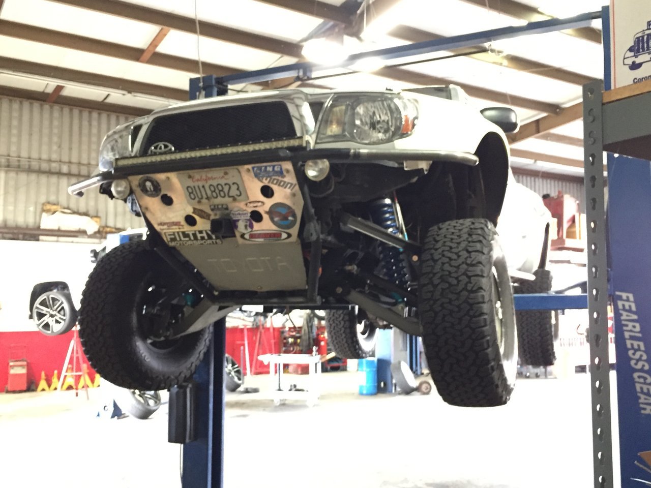

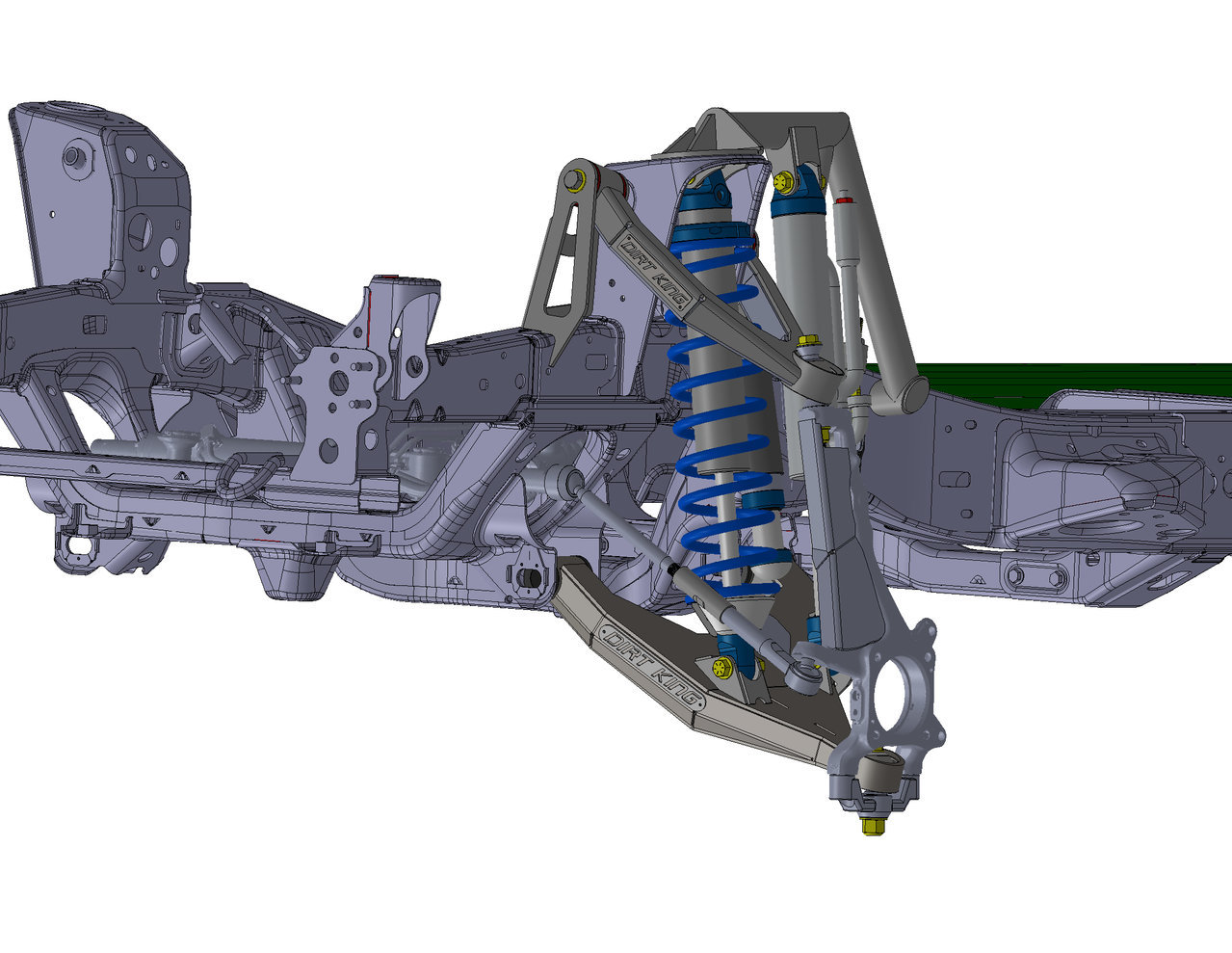

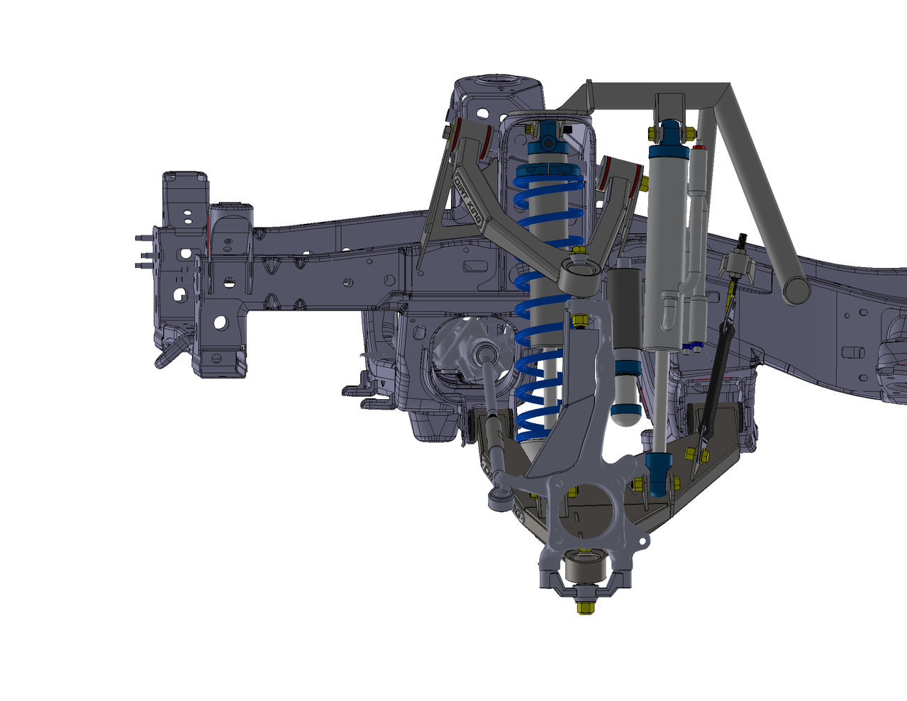

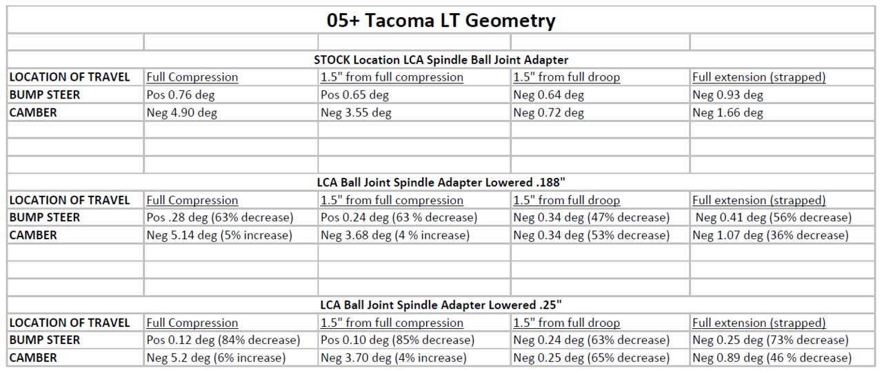

    Hey guys this is Dustin with Dirt King Fabrication and I'm here to clear things up. First of all I really appreciate MojaveMadman and snowsk8air2 stating facts instead of bad-mouthing us. If I was in their position I would be unhappy too. The problem is something we should have caught especially before shipping out any products. This issue arouse after redesigning the suspension system to get more droop. Our main concerns were over articulating the CV's or tie rods which would cause premature wear or failure. Since this was a revision on an already tested and proved kit we failed to notice as the suspension gets more droop the lower arm gets closer to the boot causing contact. A majority of the kits sold were 2WD so we didn't catch it until MojaveMadman and snowsk8air2 brought it to our attention. We quickly came up with a temporary fix (a simple plasma cut washer) so they could get their suspension installed. Afterwards we pulled up the suspension in CAD to come up with a solution. We first made the spacer change to see how it effected the geometry and to make sure it wouldn't cause them any other problems. To our surprise we found several major improvements. After testing several positions we found that moving the spindle adapter down .25" decreased bump steer on average of 76% throughout the suspension cycle. The other result was an increase in camber at full compression (also know as bump) and decrease in camber at droop. In this case trying to fix our mistake led to perfecting our geometry beyond what we originally thought was possible with the factory platform. Our findings are below.
    When it comes to product development and overall durability we understand why there's skeptics out there, we are a fairly new company compared to the competition. We've been dealing with this since day one meaning we always have to be at or above the industry standard for anyone to take notice. This lead to Dirt King working along side Ram Engineering last year to develop the suspension for the Ram Rebel TRX concept truck. The opportunity alone was amazing but impressing their engineers with the finished product was an indescribable accomplishment. All of our products are 100% made in the USA using some of the best materials. Our misalignment spacers are machined in house from 17-4 stainless steel. We only use american made FK bearings and preassemble a majority of the suspension components before shipping unlike most companies. All of our products are designed to achieve the most amount of travel without compromising other components. In addition we claim real travel numbers. With the being said I have to address something tubbsisland stated: "my Camburg 3.5 kit is strapped at 14.5 with zero axle bind, no diff drop, no machined axles and my CV boots don't touch at droop". Suspension geometry isn't magic, it all comes down to numbers. For our suspension system to get 13.5" of travel with 4WD it requires a diff drop and axle machining, to get 14" it requires fender well modifications and a king coilover with a top overcap eyelet or another method to shorten the overall collapsed length. There's no way around it since the coilovers need to be above the axle on the Tacomas, FJ's, and 4Runners. Below I attached a picture showing before and after axle machining. You can see the difference in articulation. The CV housings look different on the exterior because one is a Tacoma CV housing and one is an FJ Cruiser CV housing. Other than the appearance I assure you the two parts are identical making the machined and not machined numbers an accurate comparison. They were measured off of a precision ground and level table with a digital angle finder.
    Another mistake we made was thinking the 05-15 Tacoma frame was the same as the 16+ Tacoma frame. We thought that since the suspension pick up points were the same the rest of the features would be the same or very similar. That wasn't the case and caused our upper arm double shear kit and bypass shock hoop kit not to fit properly. We developed the shock hoop kit off of a 2015 Tacoma CAD file. It requires you to cut off the factory bump stop mount for bypass clearance. We made sure there is enough room for 2.0 x 2.0 bump stops to fit along with the bypasses. Everything is designed with a purpose and we try to accommodate everyone's needs. I attached a few photos of our suspension system and available options.
    I hope I answered most of your questions and will try to say up to date on this thread. Dirt King Fabrication has been rapidly growing over the years and I appreciate hearing your feedback. Everyone here at Dirt King were off road enthusiasts first and fortunately able to make it a career. Were always happy to help with anything we can. Thanks to the supporters we hope everyone has a great thanksgiving!
