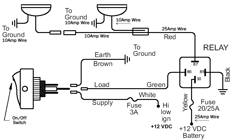

    Who in here can tell me how to wire a relay from my onx6 bar to my switch pro in such a way that I can turn it on and off and not put the load on the switchpro?
    Already have one onx6 on the switchpro so I can't add another 30amp item to the unit without a relay

    use the relay output from the switchpro to trigger another relay.

    I'm sorry man, can you write that in crayon?
    Us Marines aren't too smart

    lol sure.
    so in the pic below, take the pos wire running to your existing light from the switch pro box, splice into it and run it to the green wire in the pic.

    And that basically keeps the switch pro in control but takes the load off the unit?

    correct, your switch pro is still turning on one light bar and also triggering a relay thats pulling power from the battery. Is your switch pro full?

    Nope it's got 6 open spots
    But a onx6 bar is 30amps
    And I have 2 of them
    The current switch pro is not designed to handle more than one 30amp device.
    So if I want it to run both bars I have to remove that 30amp load from the switchpro

    I would put both and all auxiliary lighting on relays and not load thru the switch.
