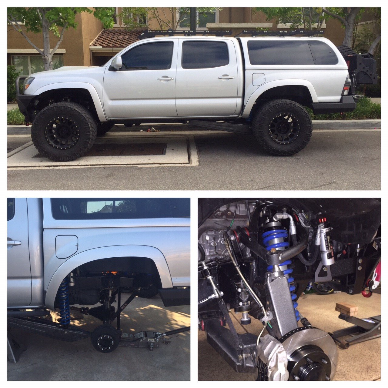

    My exact set up...+2 front and linked rear = not a waste at all. IMO linking the rear end is not just about the travel numbers. For me it was about zero axle roll, easy pinion adjustment, easy height adjustments if I am loaded down for a trip, easy spring rate changes etc. The travel is just a bonus for me, I did not want to penetrate the bed because I have a camper shell that I use daily so we designed it around a 12" CO that tucks inside the wheel well and it still yielded 20" of travel. truck 1.jpg

    Who made those links? Shock mount bolt looks above or even to centerline?

    @jeffz0rz made them, you are correct it is very close but we made wobble stoppers so the links do not lean. I've noticed a lot of people don't use a heim at the front to get around that ? I've never personally cycled / articulated a set of links with bushing front pivots does it actually limit anything ?

    The bolt should be belowcenterline but a lot of desert guys use the bushing setup because it’s cheaper and acts as a built in wobble stop... but the bolt centerline thing is more important
