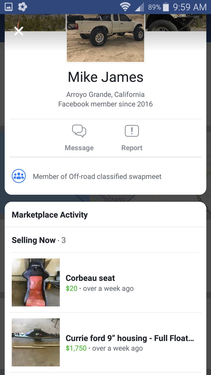

    Screenshot_2017-12-23-09-59-47.jpg NM. I think someone was looking for one of these.

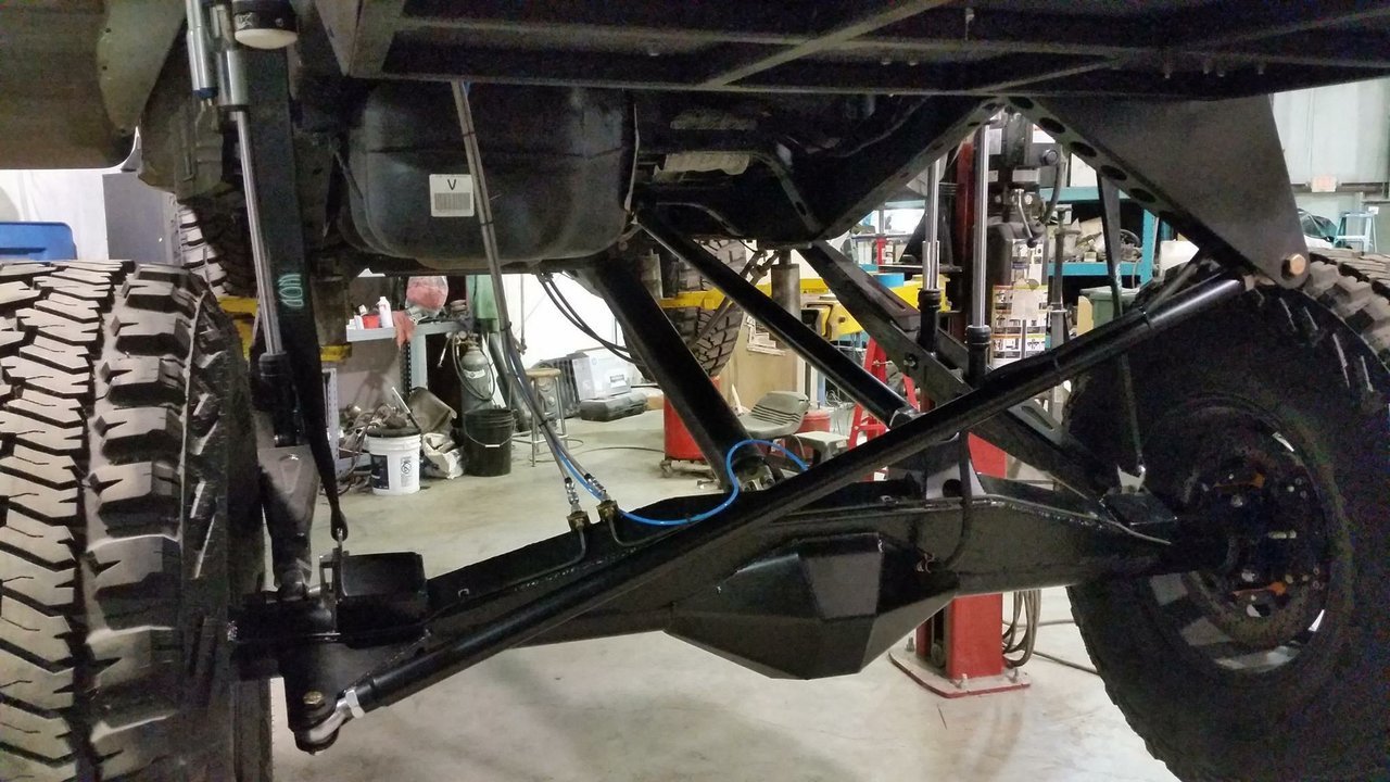

    is your tire rubbing on that left link? how much lateral sway does it have?

    It looks like at drop the axle is pulled way to the right? Is that normal with that setup ?

    Normal for a panhard bar setup like this. Everything should be cycled and adjusted so nothing hits though.

    The axle will travel on a radius dictated by the length of the panhard bar, that is why a longer panhard bar and a properly located panhard bar are key. The longer the panhard bar the larger the radius of the arc which equates to less side to side movement.
