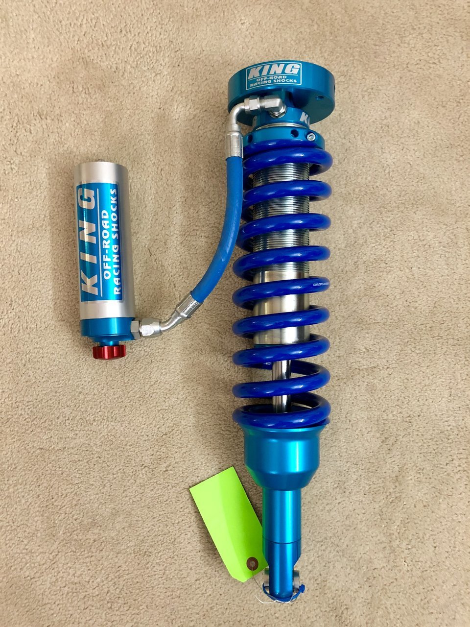

    Question for you pros.. 2018 trd pro tacoma .. i have kings 2.5 with the 600 lb spring. I heard to adjust the preload before installing so itll be easier because adjusting it once on will be a bitch. So approx how many threads should i aim for to achieve 2.5in of lift? I heard to do the drivers sids 1-2 threads more to fix the “taco lean” . Thanks fellas

    If its anything like a first gen, remove all spring slack and add 50% of the desired lift in preload, add an extra 3/16" to the driver side.

    You’re not gonna be able to adjust those un-installed lol

    Just droop the coils out and lube the threads and all should go smoothly with them on the truck!
    http://www.crawlpedia.com/coilover_setup.htm

    Lol that’s not gonna work for these coilovers
    erok81 likes this.

    Yep. I’ve adjusted mine on the truck 5-6 times. Zero issues.
    I tried with them on the bench. I made it to slight preload and gave up. :rofl:

    I have adjusted mine about the same on my truck. Doesn't hurt to spray some penetrating oil on the threads and let it soak for a minute or two to help it slide better. I use the "T" handle in conjunction with the standard punch and it gets the job pretty fast.

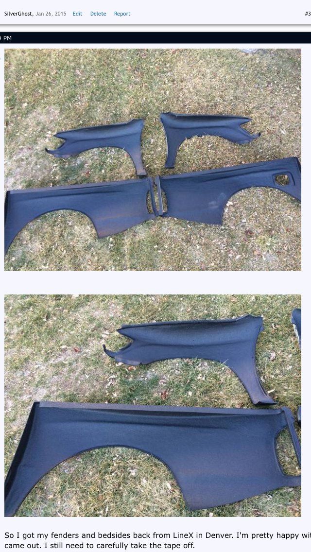

    i made my own liners out of L brackets and truck mud flap rubber. so far has worked well.

    i adjust mine easily installed. Several times.

    I said “un-installed”

    I line-x the underside because I get a lot of mud and snow here. I taped them off myself and covered the gel coat. Only ran about 250.
