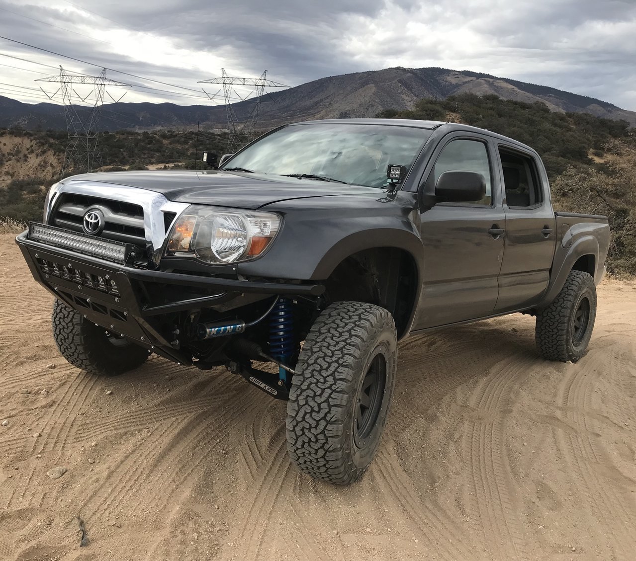

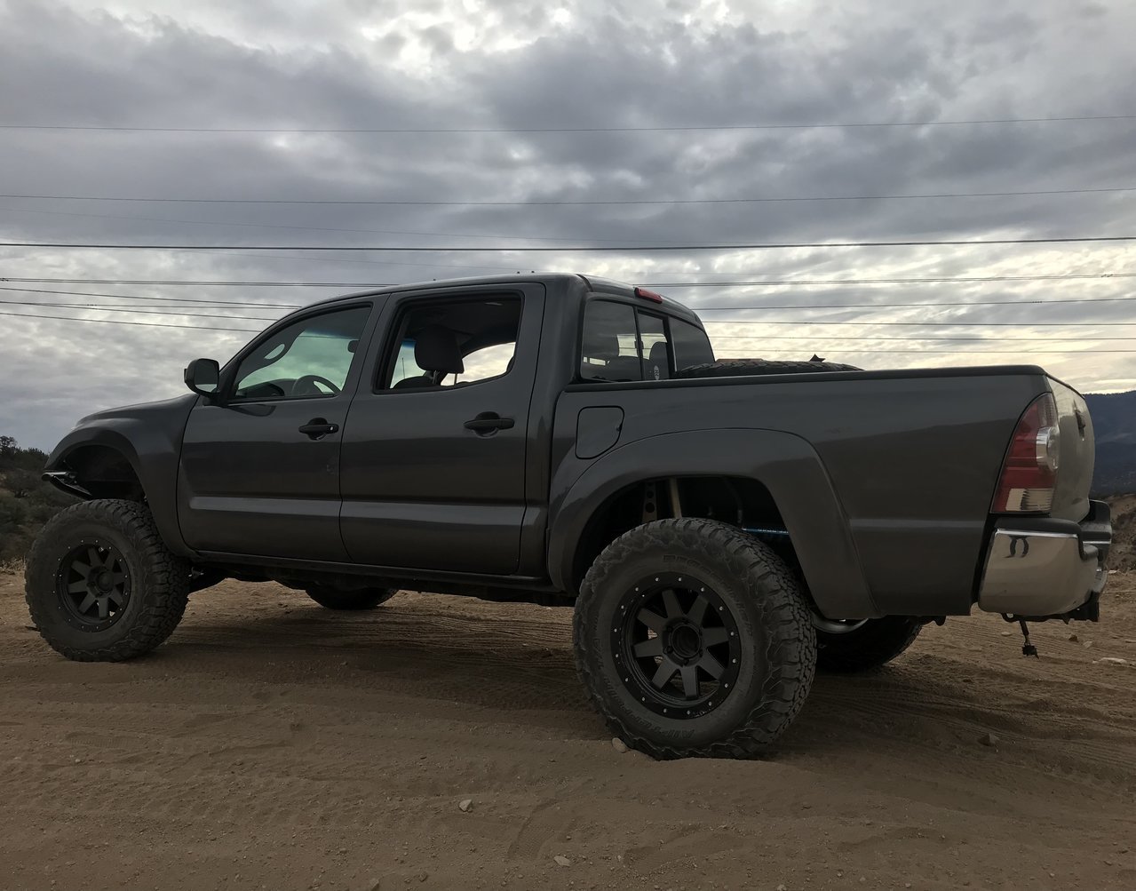

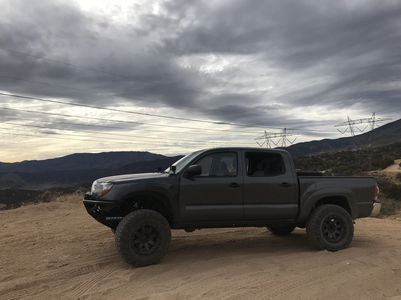

    Couple celebratory pics of my beater. It’s coming together.

    Pre-mature celebrator haha. Guy flakes on me. Oh well the search is on!

    You’re cycling 17” on a total chaos mid travel sua? Total chaos claims 12”. There’s no way you can get 17” on the set up. Got one one the kibbetech tape measurers ?

    The TC sua pls a lot like the defined kit and that kit was pulling 12” on a good day.

    Thing looks awesome. Really digging that front bumper

    Yeah I thought it sounded off as well. 13-14" is believable but with the stock mounting points it is going to be tough to pass 14.

    Thank you!!! I call it the rough draft. Tried some ideas for something we will be doing a full design and manufacturing of later this year.

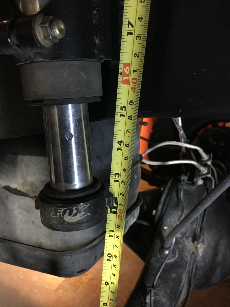

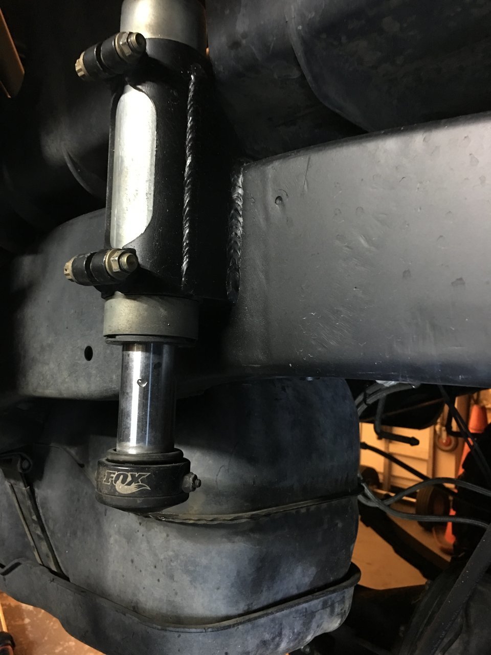

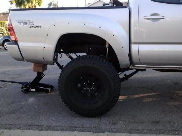

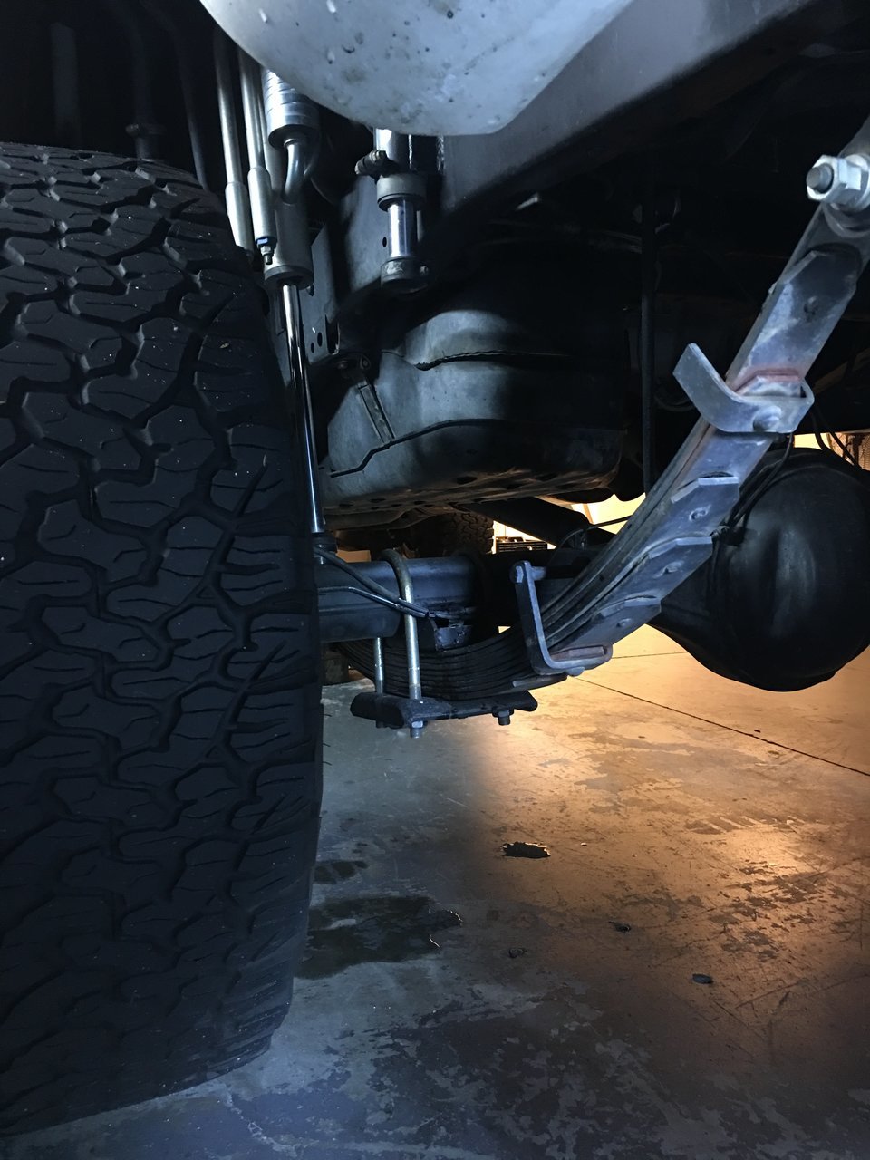

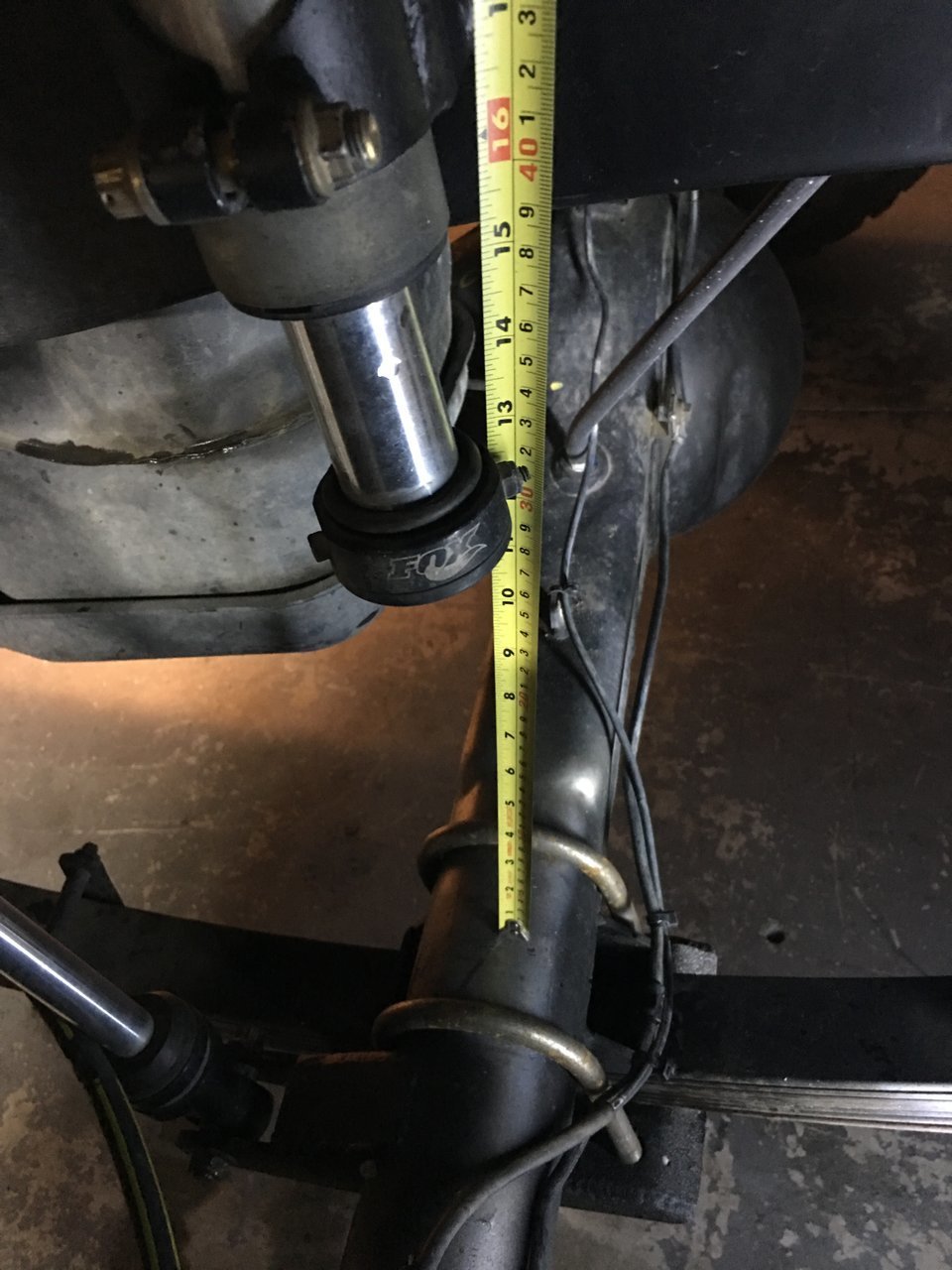

    Yep, and I have nothing to gain from exaggerating the travel numbers. I was one of the more skeptical members when Defined was starting to sell these back in the day. This is also with a 10.5" Tundra axle, that has 3.5" axle tubes. You can add 0.5" of travel on a stock Tacoma axle.
    No funny tape measures here:

    EDIT: went back into my old build thread
    13.5” metal to metal 13” strapped
