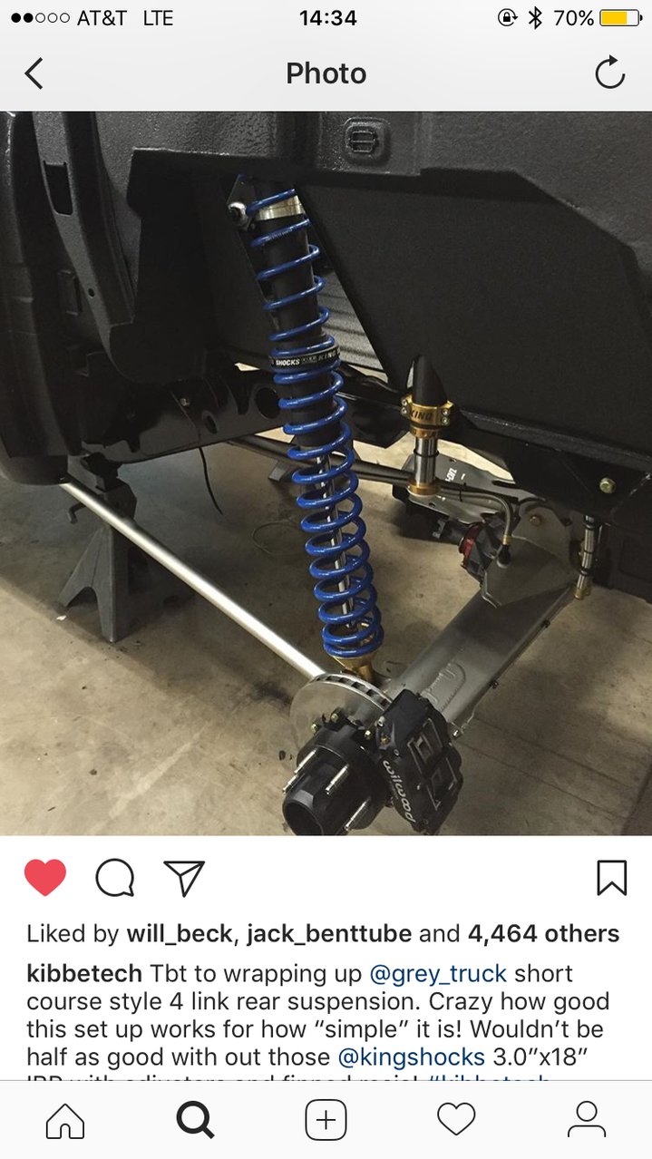

    His truck is using pocket links
    Short course links (at least the way erik intends to do it) put the coilover on the axel and the "trailing arms" are only tube steel

    The grey kibbetech truck is running 3x18" on that short course set up

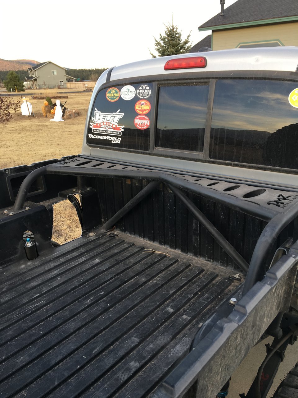

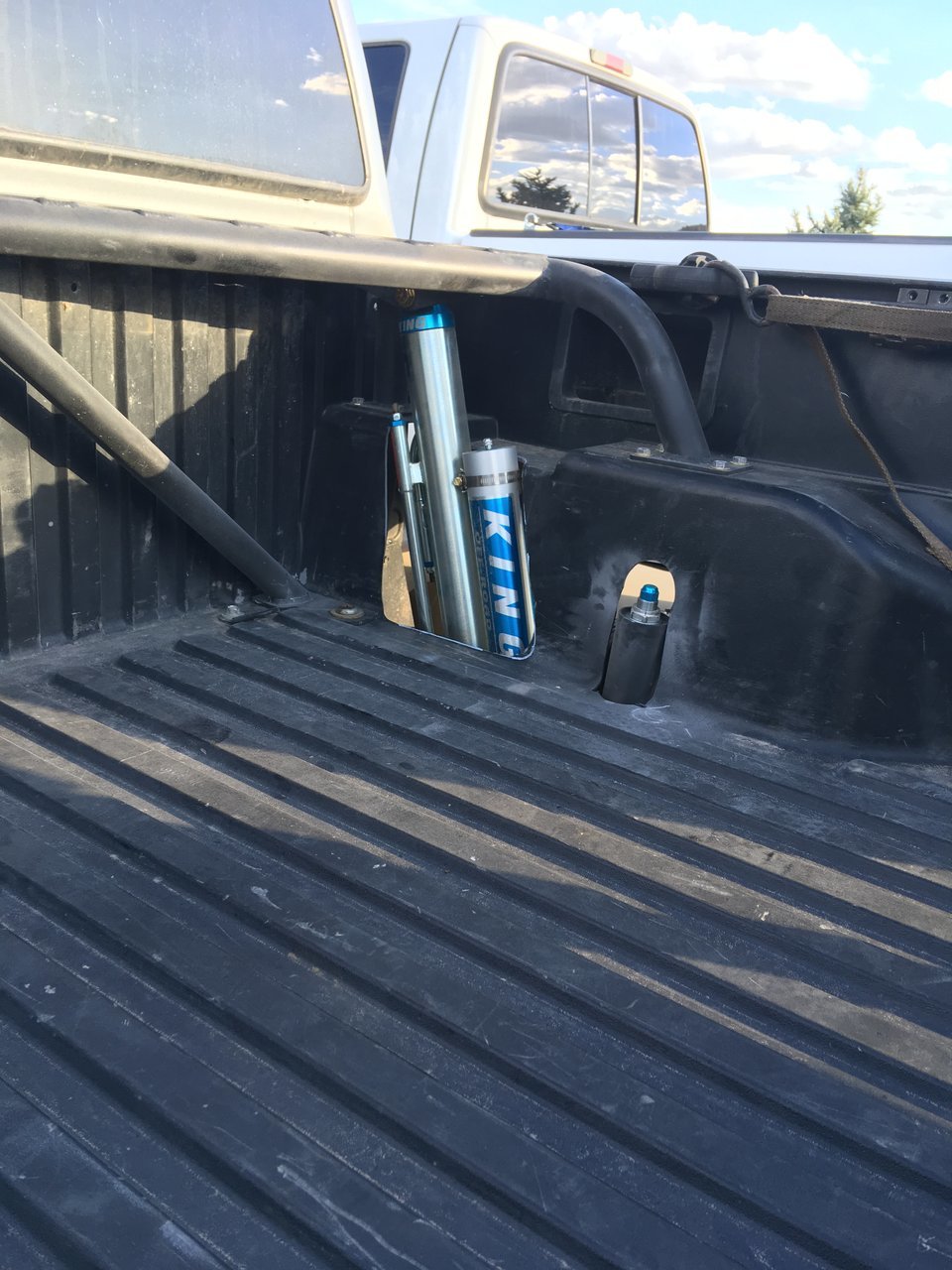

    DMZ kit and cage comes level to the top of the bed. 17" of travel or 34" flex to stuff if we are going by that measurement

    With the DMZ and Giant kits, you are limited to only so much by having a leaf LT rear. With that being said for the DMZ and giant kits, there is little advantage to having 18s above the bedsides vs 16s as you wont really pull anymore travel than 17 inches. I know that DTF makes a leaf kit that will cycle 18", but will also be above the bedsides. Link and their design is a completely different beast.
