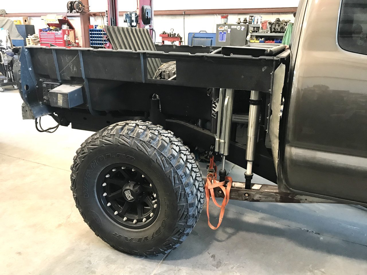

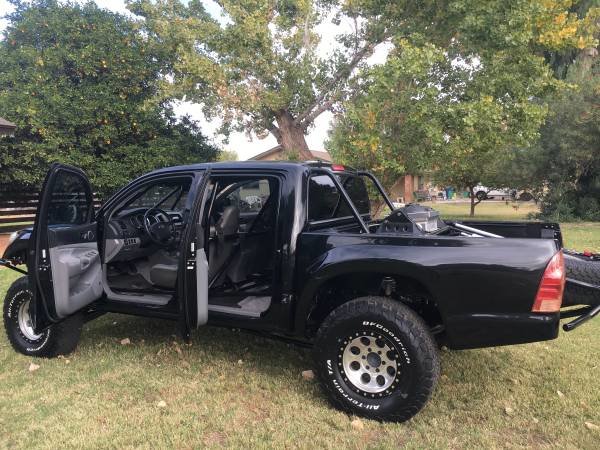

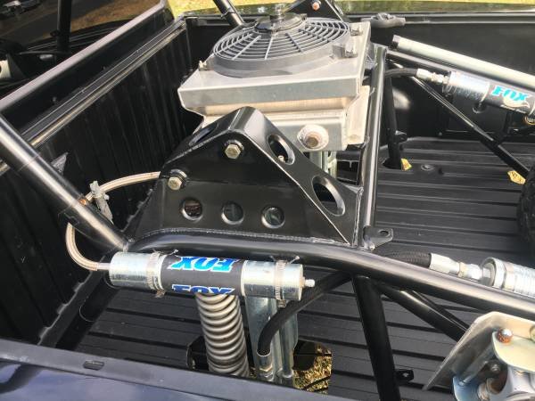

    Here is a truck that was built for a friend of mine. He ended up doing short course style but still used a coil over and bypass, so may not want to sell the bypasses too fast
    and build thread

    Tube clamp for the down tube on the roll cage to shock hoop--I'm glad I won't be the first to try it.
