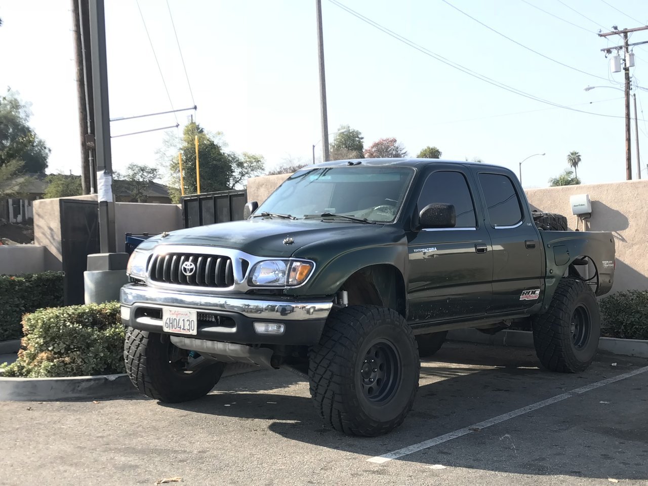

    spotted the other day in front of autozone. Im pretty sure i have seen him on here before.
