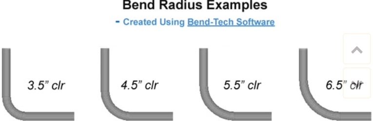

    I caged my 1st gen with a 1.75” 6.5” radius

    Obviously not making a score cage but their rules say something like bends radius cannot be smaller than 3 times tube diameter. So 1.75" tube needs at least 5.25 radius bends

    found it "None of the tubing may show any signs of crimping or wall failure. All bends must be mandrel type. The center radius of the bends may not be less than three (3) times the outside diameter of the roll cage tubing"

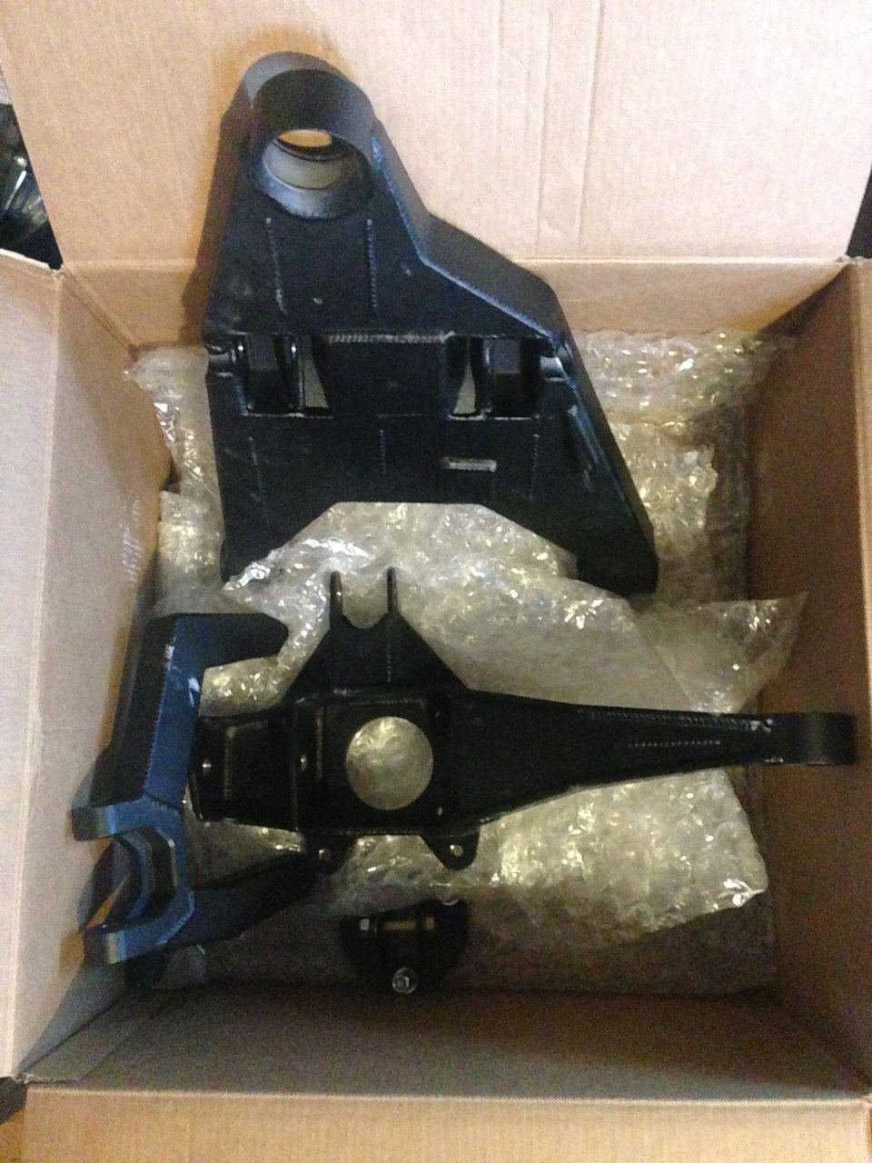

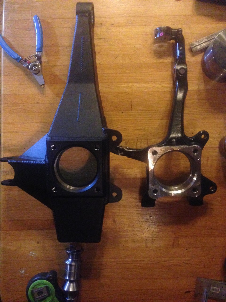

    I received my LSK kit last week and had some time over the weekend to really look things over.
    First off dealing with Van and Aaron has been great. Very helpful guys that always respond, any issue that arises and they handle it.
    Van went above and beyond finding the best freight shipment price to get it all the way across the country. The first quote we received was shocking.
    The other thing that really surprised me was they added a prebent shock hoop with laser cut tabs to include the hydro bump brackets, limit straps, top hats, etc. Considering what other companies are selling similar secondary shock hoops for, that was a huge bonus.
    Compared to what your not getting with other LT kits the price is very justifiable. You're not just getting boxed spindles, it's a fully fabricated double shear LT, not replacement control arms that have to make due with the OEM spindle geometry. Lots of room to grow too with an engine cage: longer shocks, bumping off the UCA, etc.
    Happy I took the leap.
    I'll have some better pictures once I get everything back from powdercoat. Stripped everything to make it NJ winter bomb proof with a zinc primer.

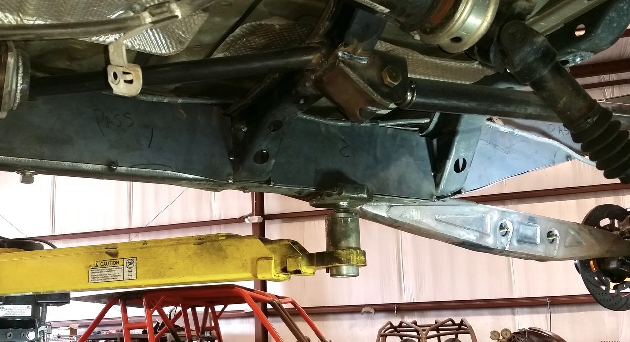

    Upper link mount, you guys think it is gusseted enough?

    Mount looks good but that cross member piece is pretty thin to start. Might want to plate that piece like you did the frame just so the whole piece doesn't tear off the frame, that tube should help though too

    I would throw a lot more plate at that crossmember. Box it in as much as possible and add overlays. It would be a good idea to plate in that tube support too.

    Yeah plate that crossmember big time.

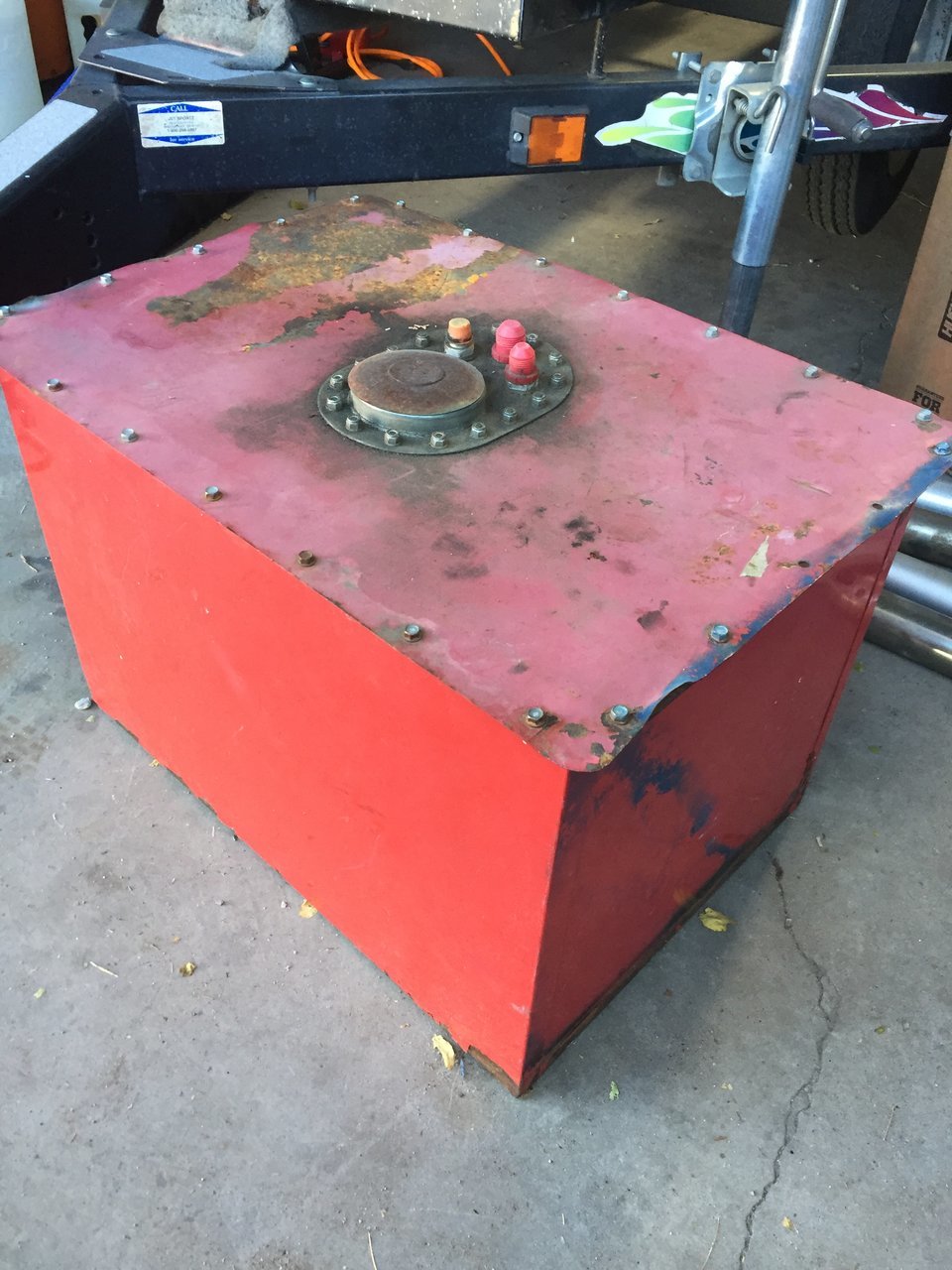

    Got this guy free today. Brand new inner tank. Just need paint. Any one with cells wanna help me out easiest way to get this going? I have an idea I want to use the stock fuel pump and emission stuff but gonna use a separate filler. Do I need the emission stuff for the truck to run proper? I don’t need emissions where I live so it’s not a biggie
