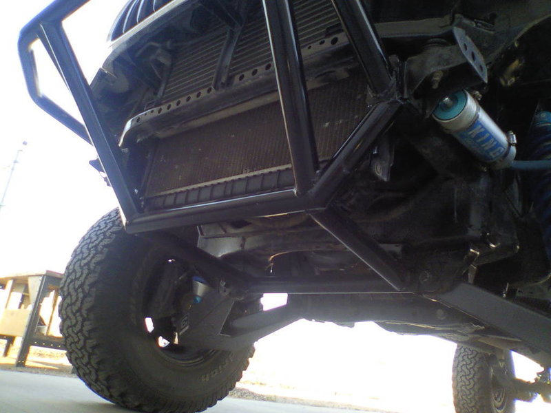

    My last alignment was in 2012, still drives straight and steering wheel still dead center, still have OEM alignment cams and can still be adjusted if needed. Proper build/gusseting goes a long way, or maybe I just dont drive very fast :rolleyes:

    Metal.
    Im blown away that your truck is still in alignment! I take my truck out a couple times and I have to go back in to Firestone (thank god for the lifetime alignment). I just thought it was the way it was...I was looking into the TC cam tabs but your alignment is still straight on with OEM ones :eek:

    He has cam gussets lol..

    And camburg LCAs have joints in them too which helps relieve stress at the mounts on impacts. Not a LOT but still some which helps.

    Completely wrapped the LCA tied in with my bumper. But also gusseted everything, UCA mounts, engine cage, engine mounts, tranny mount, frame plates and the biggest help being the complete roll cage. If your frame and mounts bend and tweak all over the place it doesnt really matter how solid the alignment cam tabs are

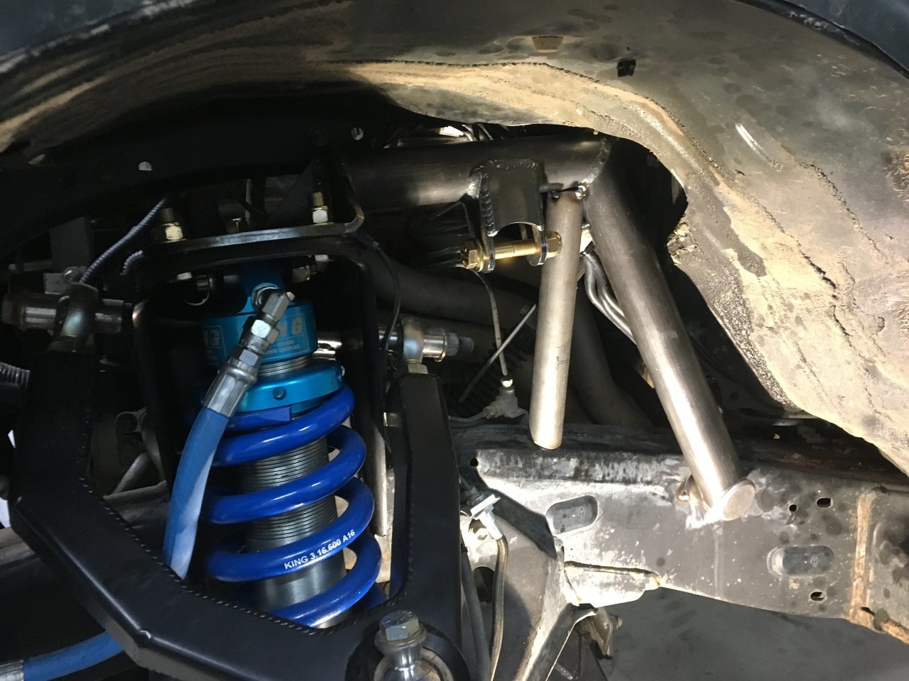

    Got one side mocked up and just need to do the other side while I wait 2 months for the shocks to show up. :mad:
