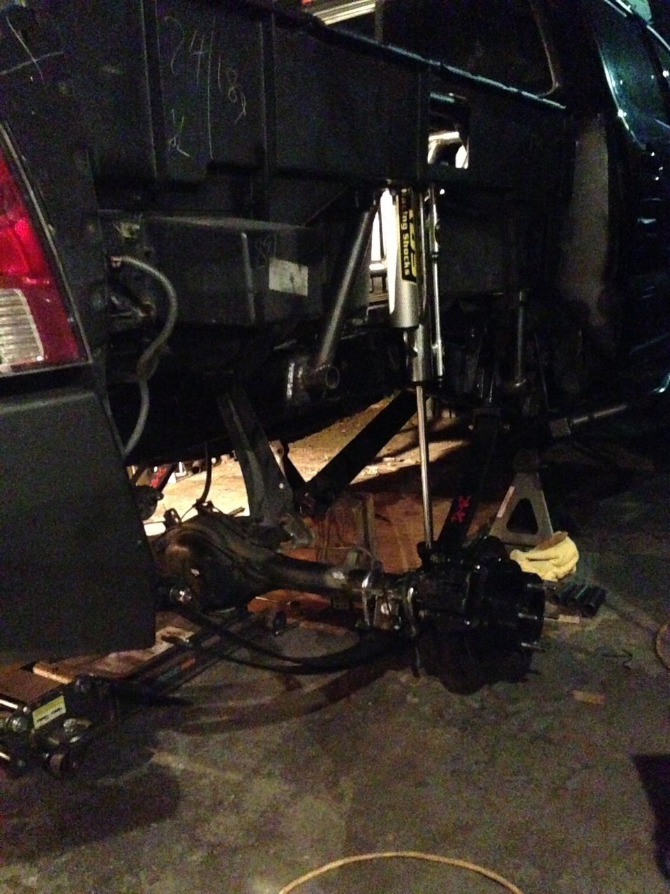

    any pic ? how much travel u getting

    Me? It's over 17" of total travel. When I first let the rear down I was shocked by how far it continued to droop. I started to worry I didn't have my frame supported high enough and that the rotors were going to hit the floor first.
