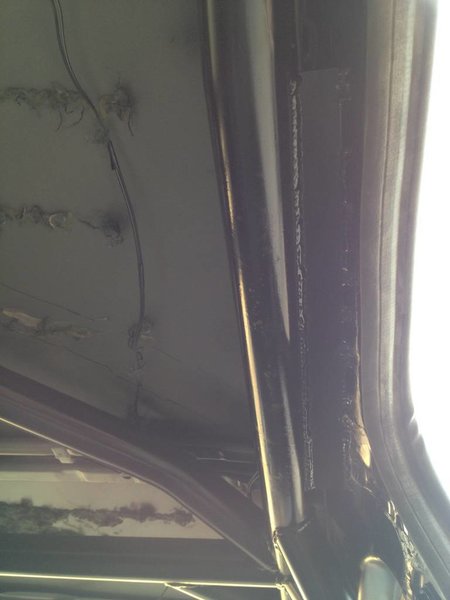

    For those of you that have cab cages. Do you solid mount the cab and weld the cab to the cage? If you do where are the weak points in the cab? What takes the stress of frame flexing and vibes. Do you get cracks in the cab? Trying to educate myself on the cab cage and what to expect.

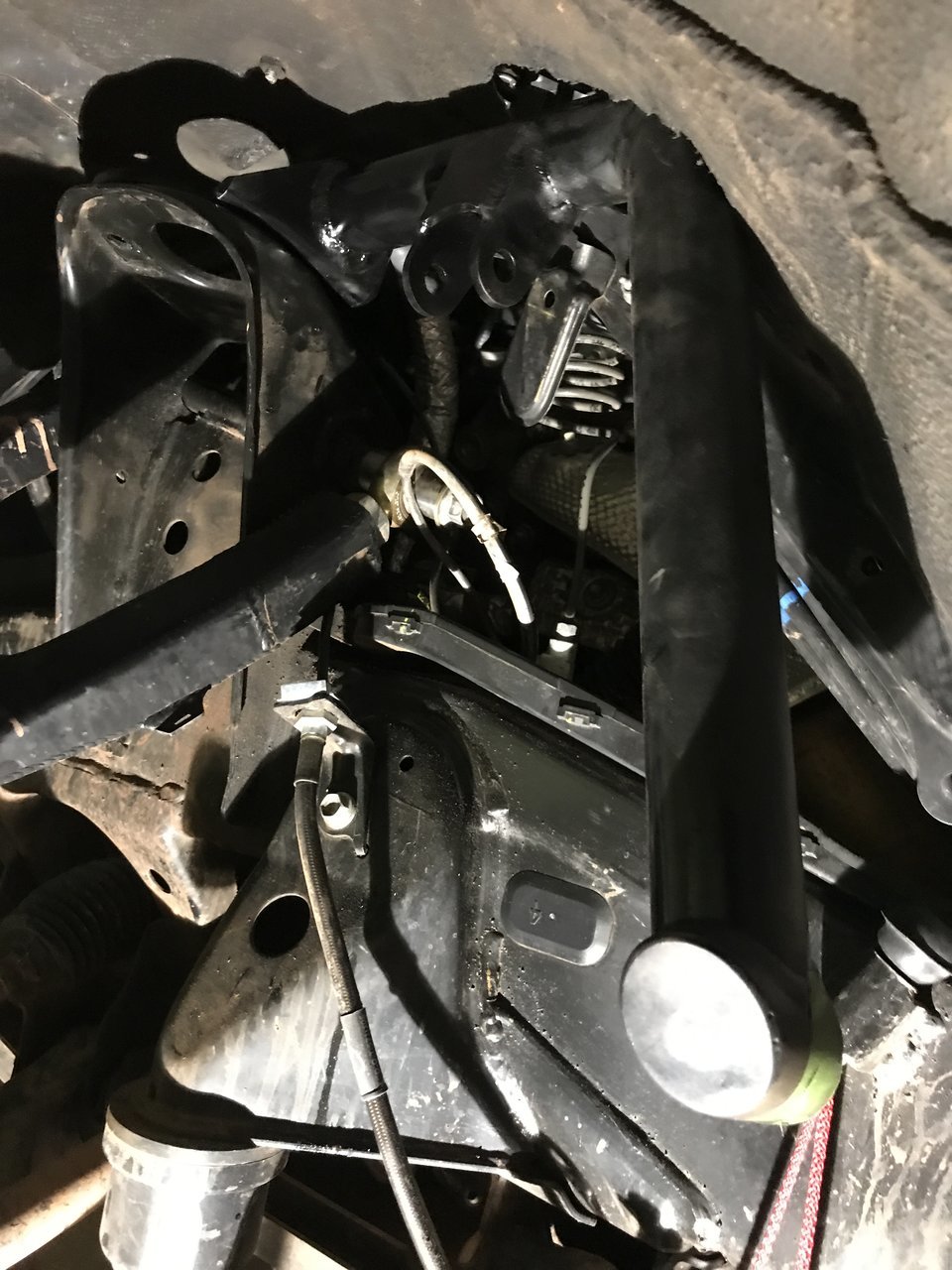

    @erok81 did you haft to cut off your old bump stop mount? I have a old shock lying around and mocked it up and it looks like it will clear the stock bump stop by about a 1 1/2". I'm going to try to plasma out a hole on top and bottom of the mount to put a king bump stop in.

    Mine had to come off no question.
    With it off I couldn’t even fit a 2.0 king bump between the bypass and frame.
    To add the bypass I had to move it off the side. It wasn’t even close behind. My bypasses are 2.5’s if that matters. I don’t know what you were mocking up.

    I checked it with a 2.0 but went off of the shaft because that’s we’re the clearance issues should come from. And I checked it again and it’s more like a 3/4” of clearance. I wonder if the frame changed from the 2nd gen to 3rd because I have a lot more room between where the bypass will be and the frame.

    Yes the frame is different

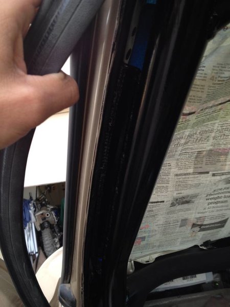

    My cab rest on the cage. It's mostly supported by the A pillar that runs up the window and out the back. Still have the body mounts. I have the A pillar at the window welded. Highly recommend that. The tubes coming in and out of the cab also hold some of the weight. Most of the weight is off the cab now. From there on out you weld parts that squeak to your cage.

    Here’s a third gen frame.

    Cool I was hoping you respond. Ok I'll weld the A pillar to the cage.

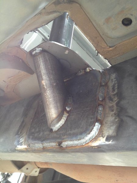

    Another thing. My double cab rear cab mount is going to be in the way of my lower link up travel. I was hoping to remove it completely. I guess if I suppot it with the C pillar tube then I can remove the rear mount. What do you think about that? Or should I just trim the mount as much as I can to clear the up travel of the link.

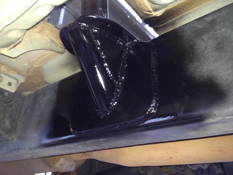

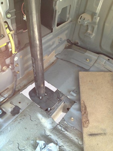

    I cut a hole in the cab and landed my C pillar tube to the top of the frame. And sealed it after. Makes for nothing in the way for lower link mounts.

    It looks pretty close to the same but I had to cut way more out of my wheel well to get the bracket to fit.

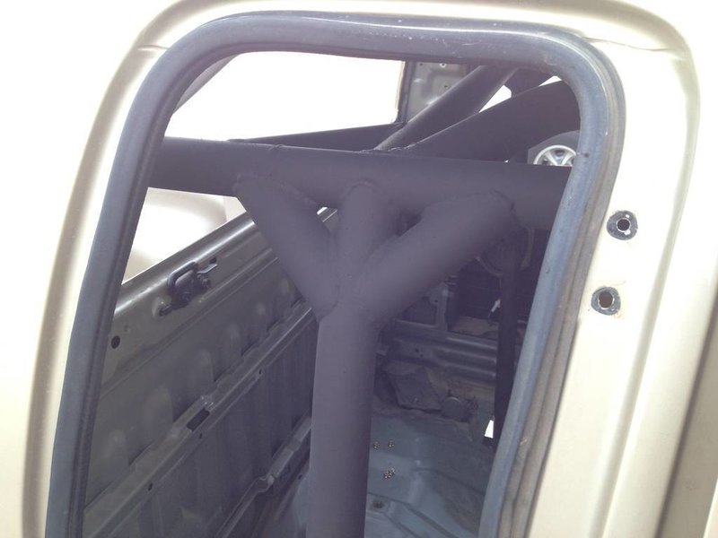

    Ok cool. Yeah I was wondering why some C pillar tubes run at an angle instead of straight down. I’ll plan for the same thanks.

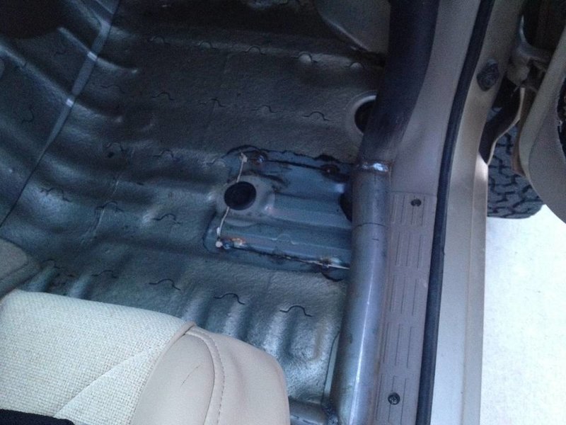

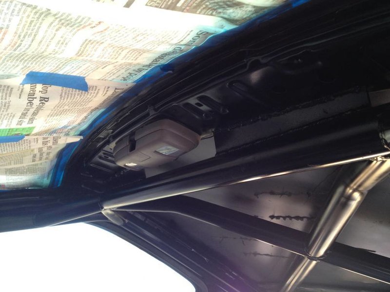

    You'll want to cut a hole in the floor of the cab and go through, then gusset the cab to the cage at A and B pillar, and then I did above the door frame and above the windshield too. Easiest way is make plates to land on instead of to the top of the frame. This way you can tack the plate, build the cage, knock the plate off and the whole cage drops to weld *360. Then lift the cage back up and weld the plates in permanent. If you cut the hole in the floor way too big it makes it easier, then just trim and weld the piece you cut out back in after its all done. For the rear body mount as long as you gusset the cab to the cage it won't move, I hacked up my rear body mount pretty far. Still have stock body mounts and my cab doesnt move at all

    My c pillar also lands on top of the frame for when links happen
