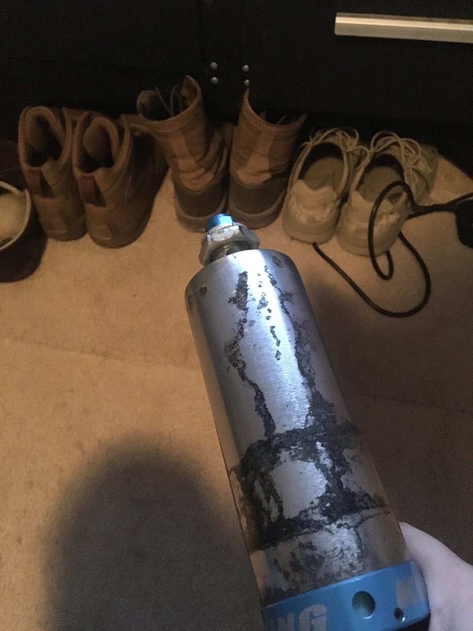

    Got the cans out of the sleeve
    Just took using a socket and a breaker bar haha
    Man is the body of the bump gross
    Tried to clean them up with Steel wool and didn't have much luck

    yeah steel wool is not gonna fix that. Just corrosion from aluminum being with steel and no great way for moisture to get out.

    Red scotchbrite pads'll take care of that. Got my aluminum cylinder heads nice and clean... It'll take a bit of elbow grease, but if it can clean exhaust gunk, it can clean those...

    Then it’s gonna rust worse
    Leave it

    my bad - is there a protective coating on them? And al doesn't rust, it corrodes :p but for our discussion it doesn't matter what the schmootz is - it's gonna be trapped in there out of sight anyway. Leave it dirty!

    It’s not aluminum. It has a plating
    Dalandser[QUOTED] likes this.

    I'll be a monkey's uncle, it's cadmium! My bad @anthony250f
