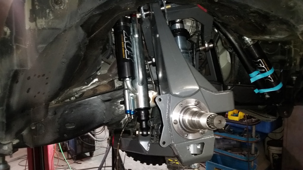

    Solo kits going in. Almost all buttoned up!

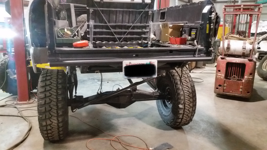

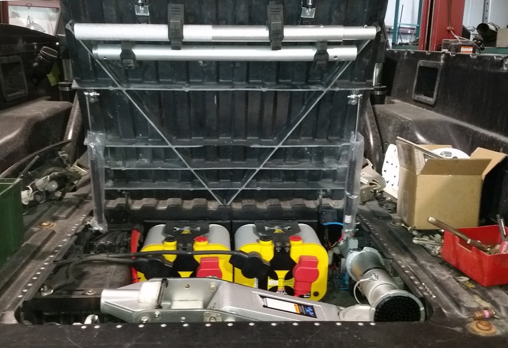

    nice use of the rear hatch!

    is that bed hatch a kit or a DIY?

    Built by my fabricator, tossed around some ideas and that’s what we came up with

    very nice. How does it handle weight in the bed? I've thought a couple times about doing something similar, but don't want to loose use of the bed.

    Can stand on it with minimal flex. Haven’t had a chance to really use the truck yet though so time will tell

    I'll stand by for reports before chopping a giant hole in my bed :)

    Solo motorsports XLT LT, foxshox
    2.5? I want 3.0 but don’t think they’ll fit

    '11 TRD Sport 4x4
    Yah 2.5, having trouble getting the 2.5 piggyback bypasses to fit, hitting the UCA. Gunna have to switch to a remote reservoir

    TC +3.5 with Kings, BFG KO2 285s on Bronze NVs, Tube bumpers with Hella 4000 converted to HID
    Had the same issue on a customers truck. Make sure you dont have them on the wrong side. the Piggy back bypasses are side specific because of the location like you mentioned. Edit- My bad just saw that it was a solo kit. Thought it was something else.
