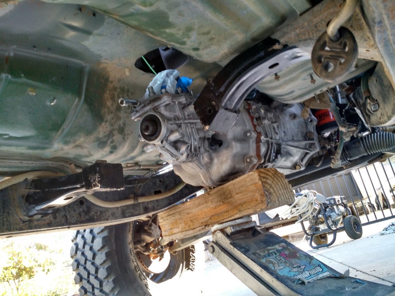

    i just want to know if i can just keep the one i have? (oem drive shaft)
    how would you go about making it into a fixed yoke if the slip yoke in the tranny

    You keep your oem shaft. Get a slip added Tap the trans shaft. Forgot if it threaded. Get a new input shaft that bolts up. Search the term "sye" slip yoke eliminated. Local driveshaft shop can get you parts and rework your driveshaft

    That's all I got. I'm 2 piece. This is roughly what I had in mind. Bolt a yoke to your output shaft.

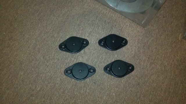

    Any one sell solid cab mounts for 1st gen. Can’t seem to find any. Or do I have to make them myself?

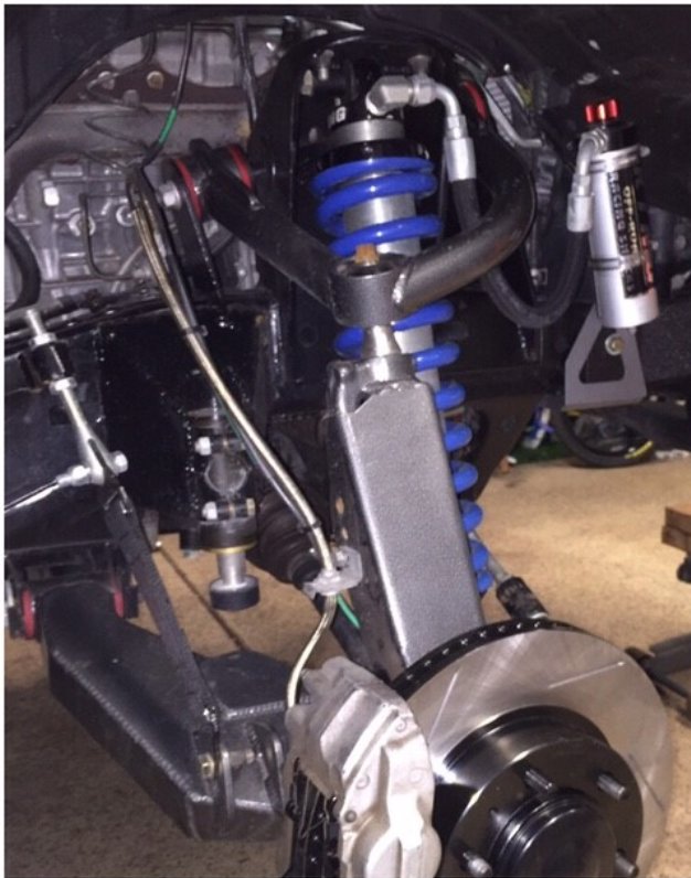

    those running a plus 3.5 kit what length front brake line is needed?

    Unless you're building it yourself
    It will be included with the TC and camburg kits and I'd assume solo too

    You'll want to get a measurement specifically from someone with the same kit IMO. Each company provides tie tabs in slightly different spots etc. Another thought too...you could use this opportunity to clean up the OE brake line mess IE: hard line - soft line - hard line and just run one kevlar line from the top of the frame to the caliper. If you want to do that just grab a piece of string, mock it up, cut it to length, measure the string and order exactly what you need from Crown Performance. upload_2018-3-1_9-32-10.jpg

    Contact Brent at Halo supercars. He has the cad data from making mine and can make you a set. http://www.halosupercars.com/blog/
  19. Mar 2, 2018 at 12:49 AM
    JuansTaco
    JuansTaco JuanInAMillion
    Nov 18, 2012
    #91397
    8,904
    Juan
    gilbert az
    2004 PreRunner SR5 stormtrooper
    ESB long travel kit, Deaver f67s with DTF 12 inch shackles.
    If you send me the file I can make you some as well! Or I can draw em up and cut em got a plasma table at work.
