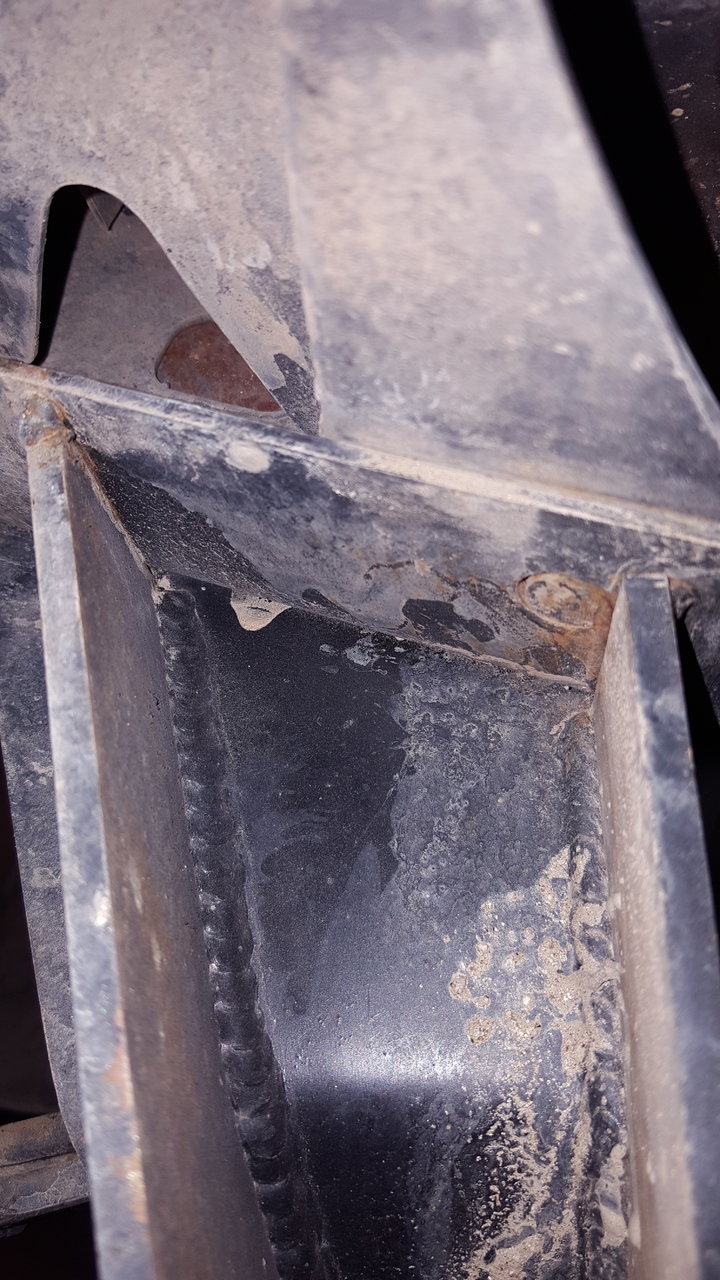

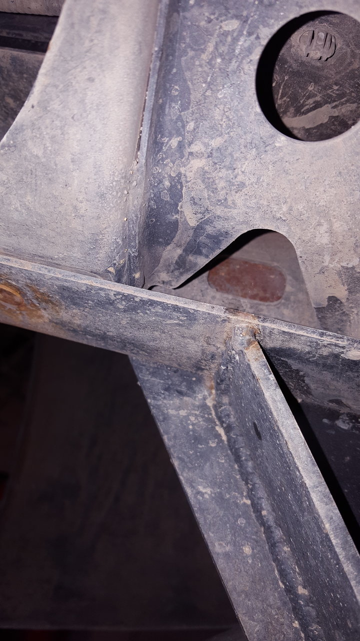

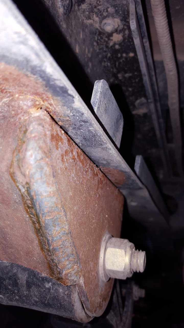

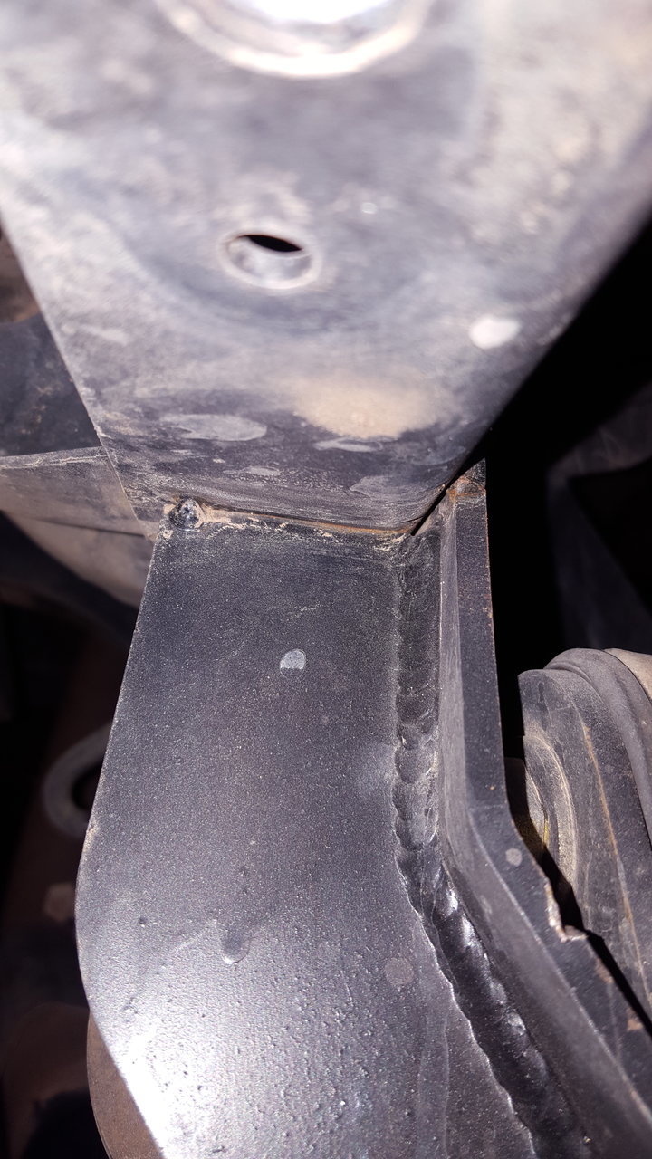

    FML, looks like I have some good garage time ahead. :annoyed: :welder:

    Maybe this is why those guys (whoever installed my kit) went out of business. :rofl:

    Well the good news is there is a smoking gun. Now it’s time to fix it. Get new bushings and make sure everything is squared up. Measure front hanger to rear hanger same side, the do the same across. Front on one side to rear on the other side. Also make sure your leaf springs are not off to one side or the other verticaly. It’s some tedious work. But you can make some tweaks and adjustments. Worst case cut off and reinstall a pivot. I am sure DMZ will sell you a replacement part. Then burn it in 360 with the glue gun. I would be bummed but don’t let it get you too much. Just an opportunity to learn more about your truck and setup. Your confidence will be much higher when it’s all done!

    All the pics are from passenger side. Looks like they spend all the welding wire on the driver side only. Yeah I'm taking it to DMZ for some more input and new bushings, and then all to the floor it is. I'll probably box the frame while I'm at it. Has anybody use steel-it?
