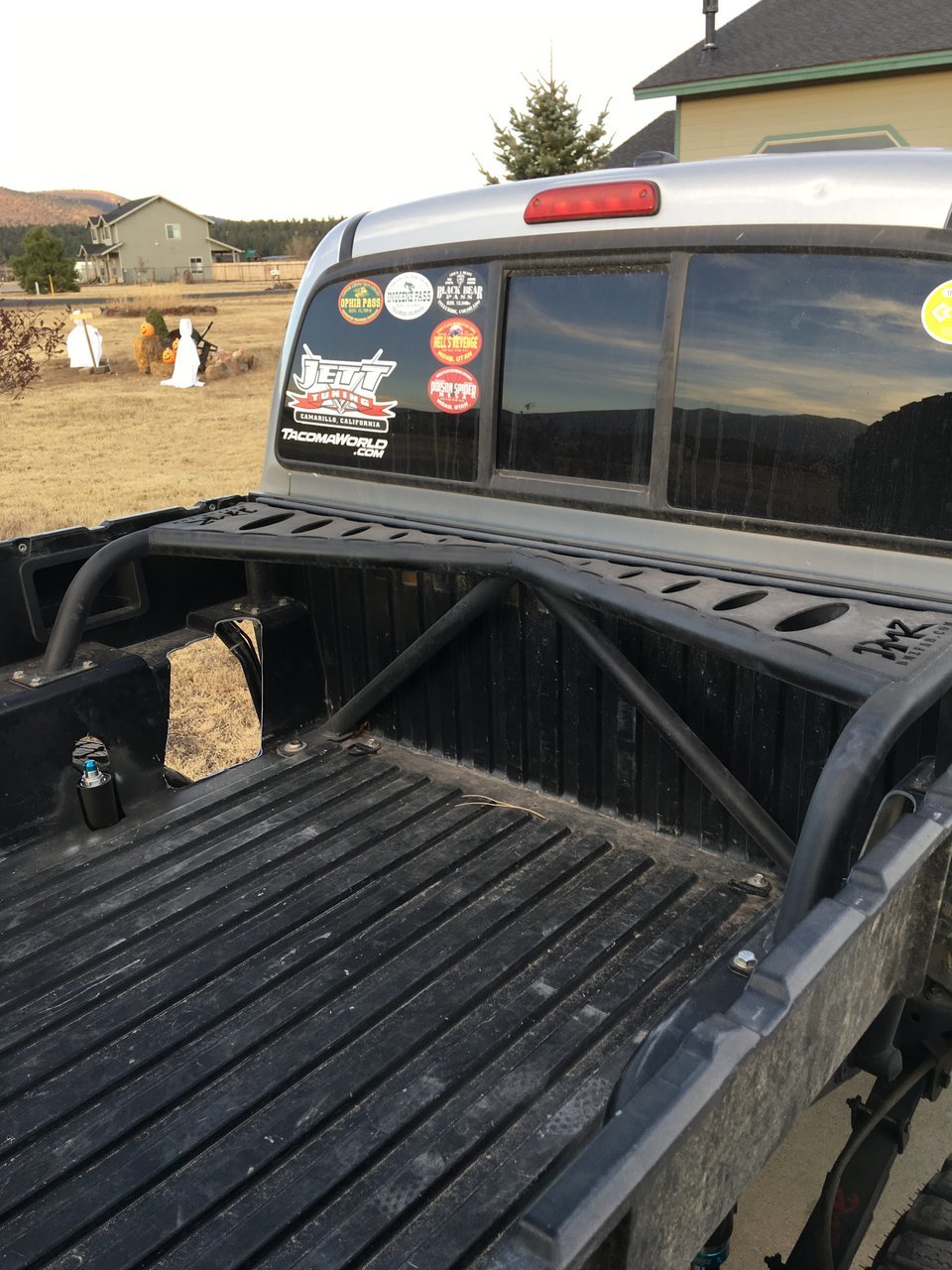

  15. Mar 25, 2018 at 11:30 AM
    snowsk8air2
    snowsk8air2 how hard can it be?
    Sep 16, 2011
    #63607
    10,541
    Flagstaff, AZ
    Supercharged TX Pro
    2011 S/C and basic mods
    It's not on the site yet. It's the cage I'm running and does go through the bed. IMG_1344.jpgIMG_1364.jpg
    dira1987, Coot83 and jeff b[QUOTED] like this.
  16. Mar 25, 2018 at 11:40 AM
    snowsk8air2
    Sep 16, 2011
    #63607
    10,541
    Flagstaff, AZ
    Supercharged TX Pro
    Comes fully welded. You just need to weld the lower legs to the frame and bolt it in. I tried getting it as a weld it yourself kit, but he wasn't offering that
    Coot83 and Dalandser like this.
  17. Mar 25, 2018 at 12:12 PM
    Coot83
    Coot83 DORKEL NATION
    Aug 9, 2016
    #194134
    13,250
    Scottsdale, Az
    2012 Baja TX
    TC 3.5 LT, RCV axles, Demello sliders, BD light bar/fogs, LP6, DMZ rear, SOS skids, custom bumper, King 16" triples, Locked-on hydro rear bumps...
    It comes almost exactly as what he has in the pic. The lower legs that bolt on underneath the bed are the ones that get welded on to the frame. For the most part though it’s a one piece. So far from what I have seen tim does excellent work.
    Mine ran me around 1800 shipped I believe.
    Dalandser and jeff b[QUOTED] like this.
  18. Mar 25, 2018 at 12:39 PM
    snowsk8air2
    Sep 16, 2011
    #63607
    10,541
    Flagstaff, AZ
    Supercharged TX Pro
    What he said. I don't have a pic of how it comes, but everything you can see in the pic is assembled. Then you just weld the 4 legs to the frame. The legs are welded and ready to go. I think the base price is supposed to be $1500 plus shipping.
    Coot83[QUOTED] likes this.
