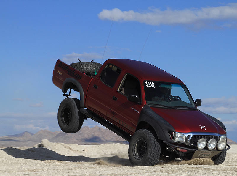

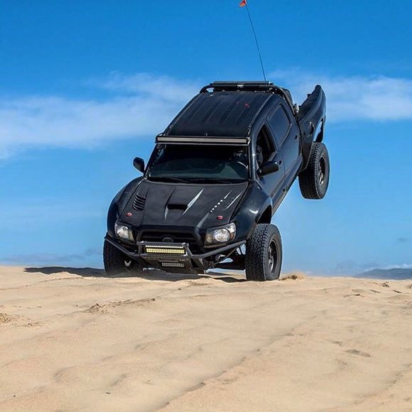

    Met up with some familiar faces in Pismo over the weekend. They found a decent jump and had some fun.
    Chris T4R lands so damn clean

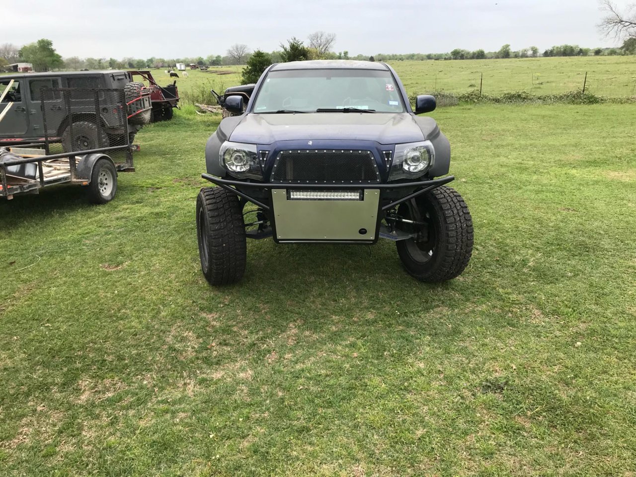

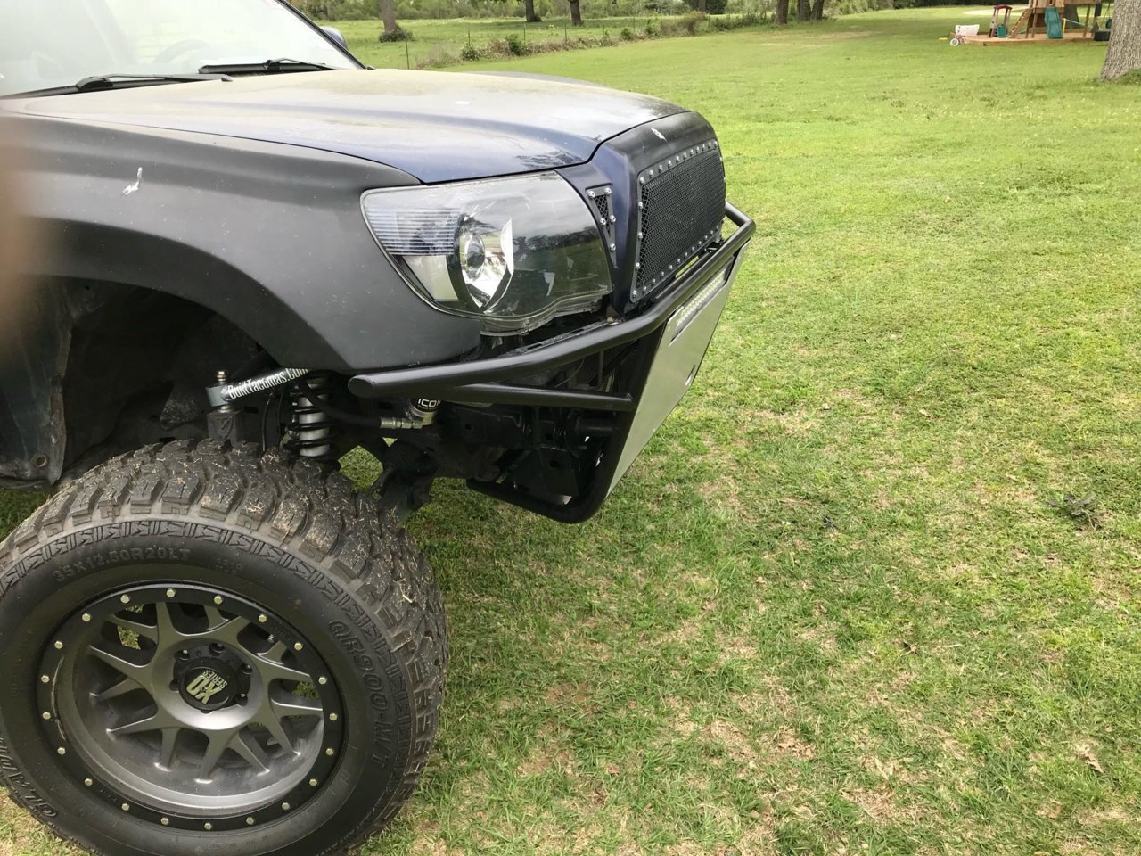

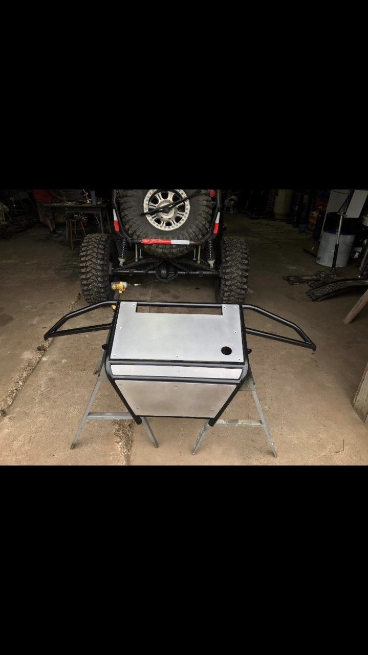

    My front bumper is almost done! I should be getting my truck back tomorrow. I know its not as angled as most would like, but it keeps the factory front crossmember. Also, I don't purposely hit things that will hit the bumper, and I would rather have a bumper to stop me than to push me over if I lose control

    What's the hole for?

    The factory tow hook is still in there

    did you make it more for looks ? your skid plate?

    I don't think anyone builds a bumper with the intention of making you roll over :confused:

    if you do this that bumper not going to help you, it might make you flip because there no angle.

    I doubt it’ll make the truck flip. It’ll just bend the frame up at the crumple zone or roadhouse the bumper mounts on the frame since it doesn’t look like it bolts to the frame anywhere else.

    I would have given it bonus points if it was a secret bottle opener lol

    ya but, hole point of the angle on the bumper is to help push the truck back up into the air and help slide on top of the sand i just do see that happening with that skid plate that all.

    Ease into the jumps and adjust suspension as NOT to lawn dart instead of making a landing gear front bumper and stand on the gas.

    That’s just silly. The angle on the bumper is for improved approach angle and ground clearance. Bumpers aren’t built to aid the suspension in doing it’s job
