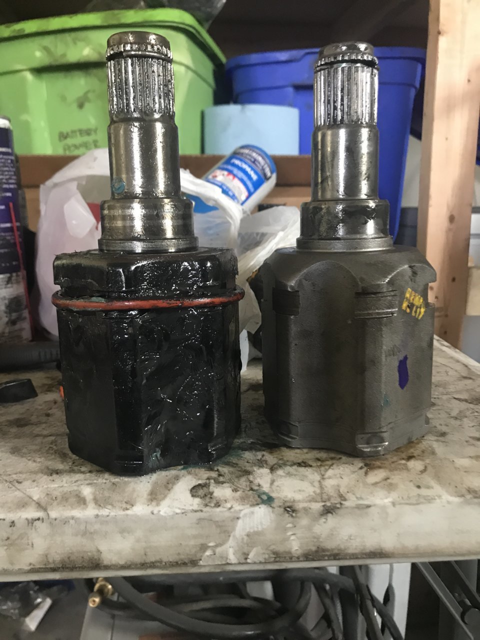

    Anyone know how to tell if a cv axle is oem? Things I can look for?

    Lobes or ridges on the Tulip side is the easiest way. That being said some of the remans have the same thing. The remans though have rounded ends on the part closest to the Diff.
    image.jpg Left is OEM, Right is reman

    Thanks! I’m looking at some on eBay and asked the company if they were made with oem parts. They said “Yes the re manufactured axles are OEM parts they are from the original equipment of the vehicle”
    It looks like the one you have on the right. Will that work or should I keep looking?

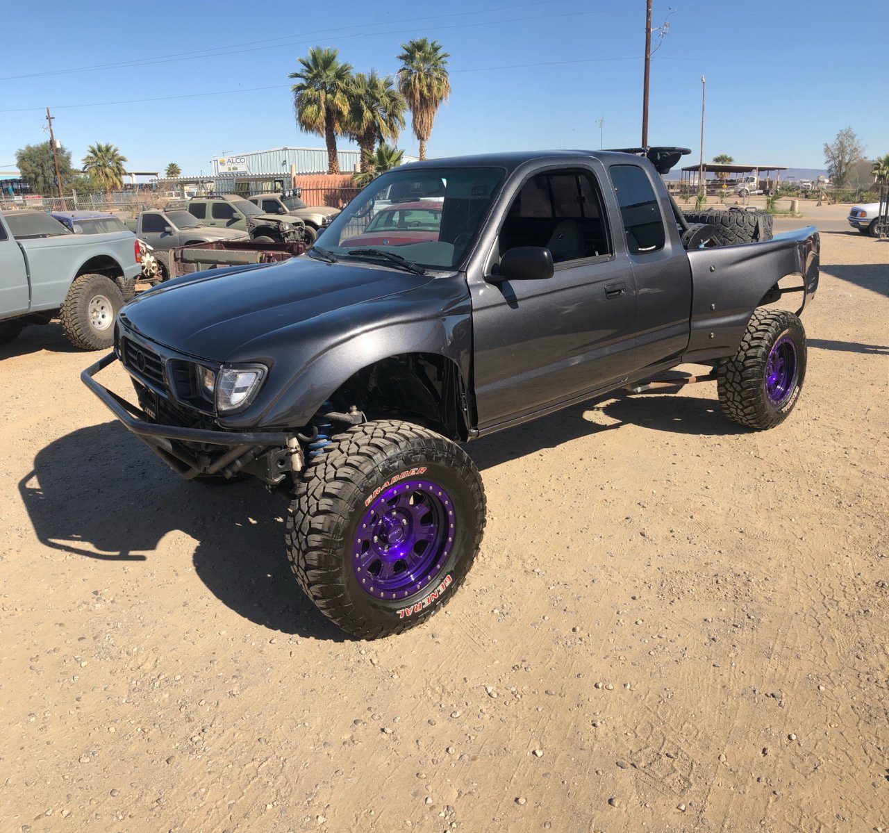

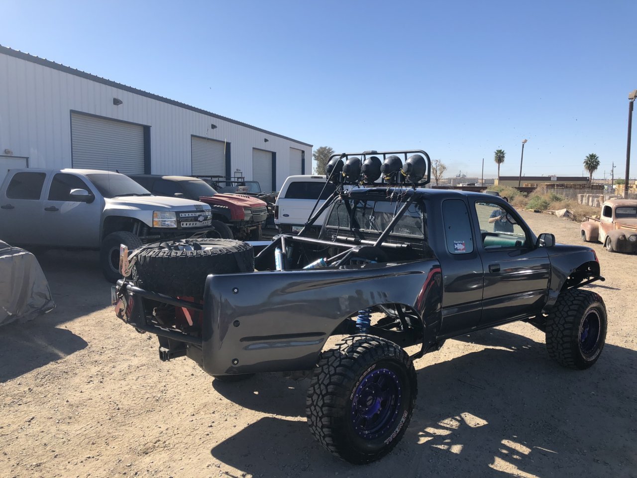

    Truck is finally painted...feels good to have a truck that’s one color for the first time in a few years lol

    I liked the two tone thing you had going on, but super clean now!

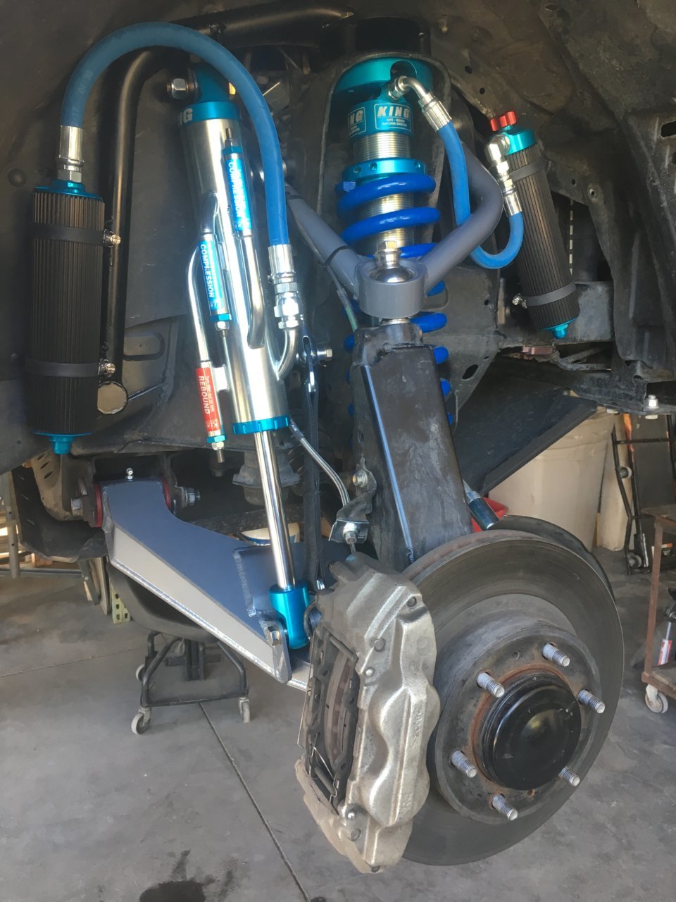

    rides decent out of the box. gunna drop a little more preload out since I'm running 700's up front

    The interals of the one on the right were not compatible with TC axles, it was from a CVJ reman. CVJ told me their axles are OEM remans but again not compatible with TC axles. I asked them about it and they said it’s because some of theirs are from Japanese OEM parts. I think it is a lie. I bought a reman from Napa too to look at and it is the same thing as th CVJ. The only ones I found that will work the the TC shafts are actual Toyota OEM axles

    this is correct. NAPA and similar have a higher (IIRC) spline count. Ran into the same issue with my old truck

    Yep 30 vs 29 is what I was told. As far as I can tell the interior dimensions of the joints/housings are identical but the race and spider are a little different due to the different spline counts.

    So theoretically you could use a oem race, spheres and cage in a reman housing. Also a OEM spider in a reman tulip. I may use the parts I have to put a spare together like that and see how it works.
