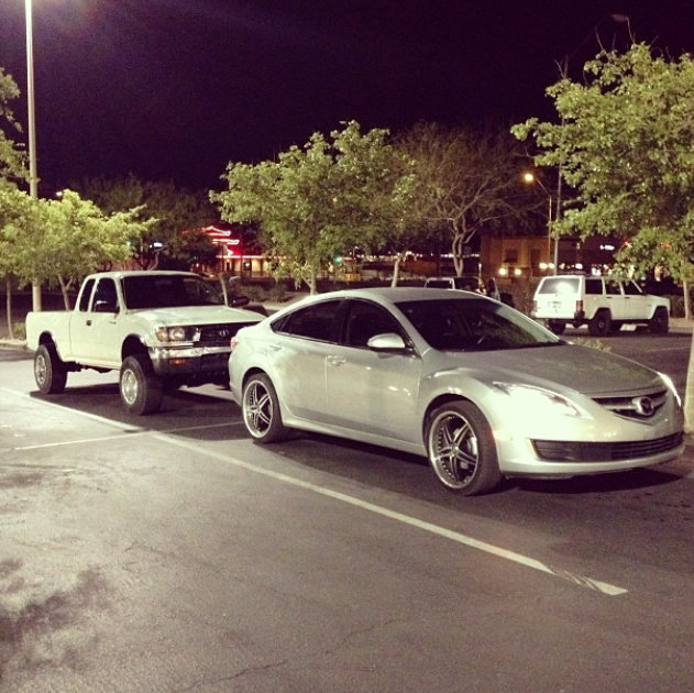

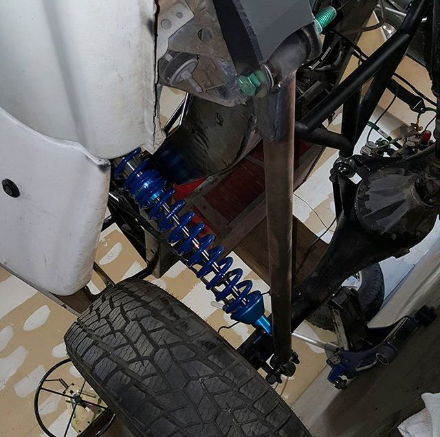

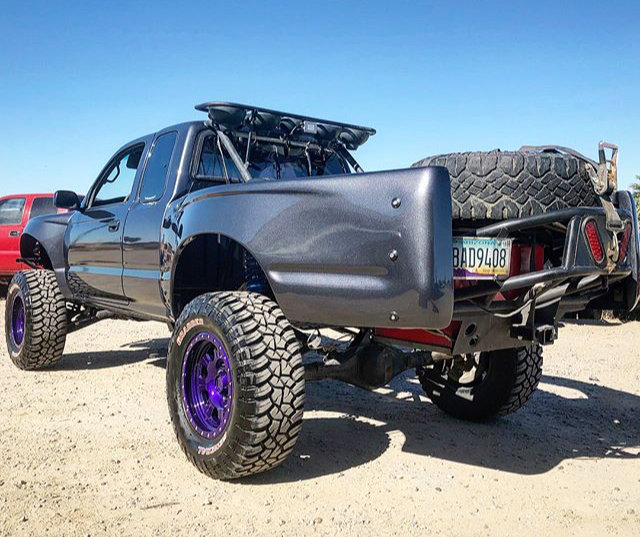

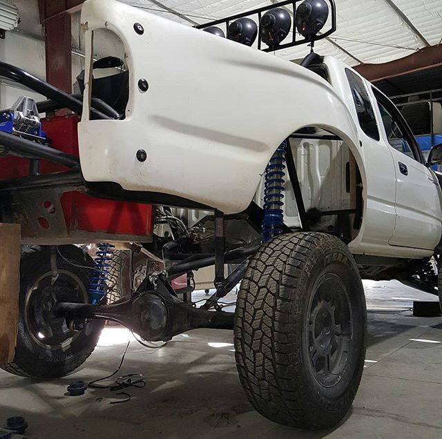

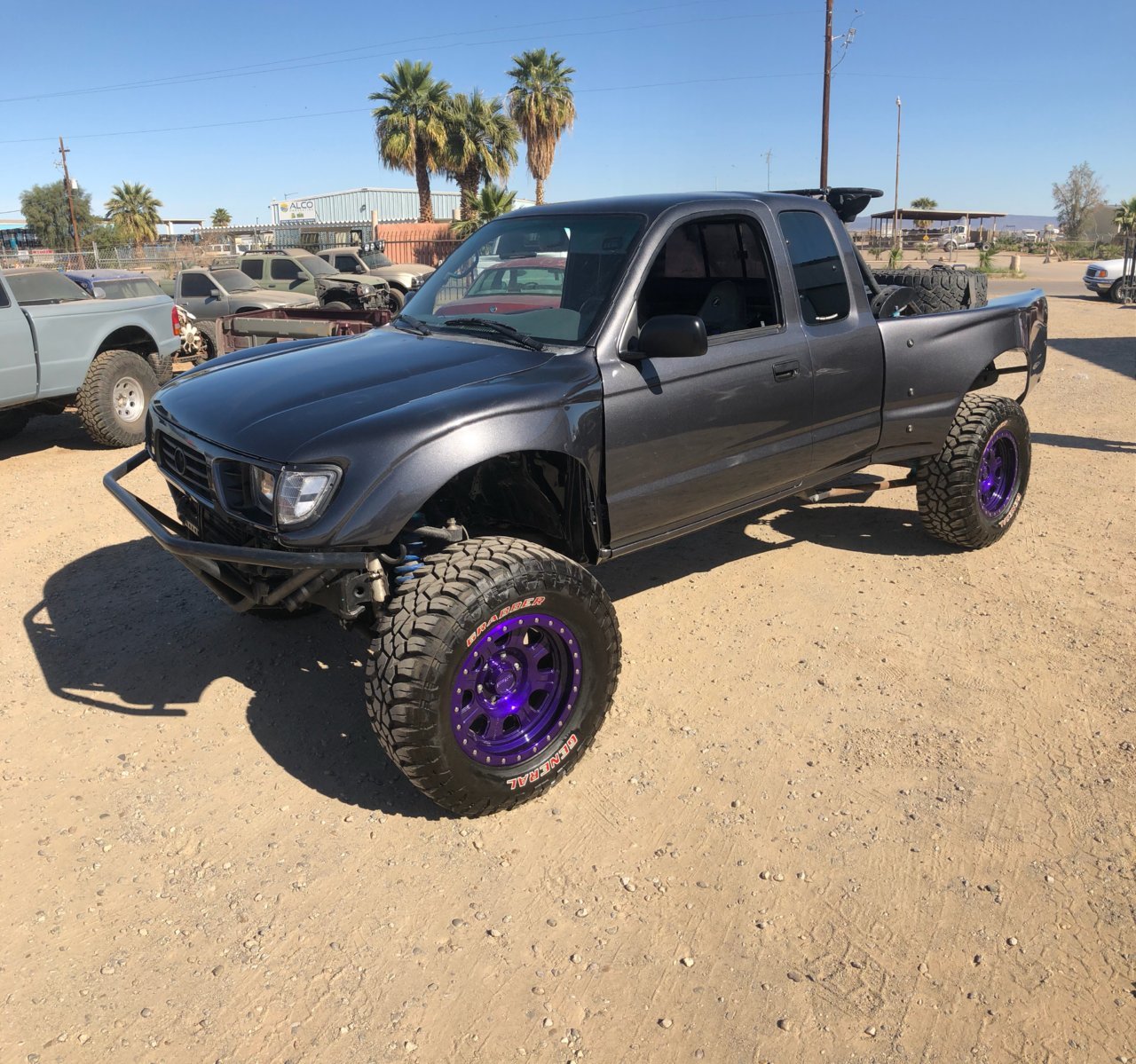

    Total chaos long travel kit 8" king coilovers Short course 3 link with 16” king coilovers 32 gallon rci fuel cell Msd fuel pump Mini d2s 4.0 retros 5 hella 4000s hid McNeil fenders Fiberwerx bedsides
    Here’s a list I made not that long ago
    2.5 8” king coilovers
    Fox 2.0 bumpstops (x4)
    Bilstein 2.65 17” 4 tube bypasses-gone
    Deaver f55-gone
    Deaver 67-gone
    Short course 3 link-current
    DOM bed cage
    Partial cab cab tied into bed cage
    Foldable light rack mounted behind cab for 5 hella 4000s
    5 hella 4000s concerted to 70w HID
    McNeil +6 fenders
    Fiberwerx +8 bedsides
    T100 rear end
    Locker
    Tundra 4wd axles
    Raceline Monsters custom painted purple
    General Grabber X3 33x12.5 17
    Prerunner tube bumper
    Mini D2S retrofits built by yours truly
    CBI bulbs
    Hylux ballasts
    Pilot housings
    Custom Magnetic Metallic Charcoal paint (Truck currently getting painted)

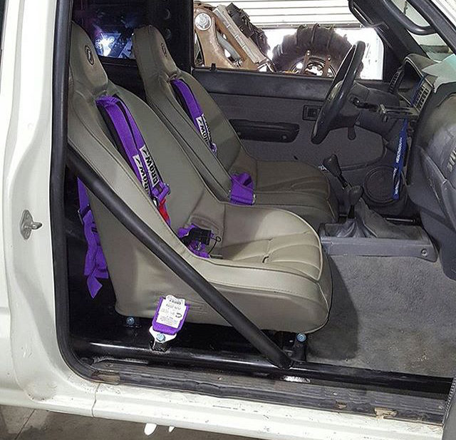

    Grey Corbeau Baja SS bucket seats
    Crow Purple 5 Point harnesses
    BOSS double din touch screen
    Custom intake
    Interior shot:
    Current:EFD40616-BC7F-4BA2-9544-52B5836BDEB0.jpg9B55D196-2D3B-4301-B624-9E35C4E49658.jpg
    I just woke up so I’m still groggy lol but later tonight I can give a full run down of the truck from beginning to where it is now

    They are 16” coilovers
  7. Mar 31, 2018 at 7:57 PM
    Siktaco
    Siktaco Well-Known Member
    Mar 21, 2013
    #100235
    261
    Robert
    Yuma
    1996 Toyota Tacoma long travel
    Not really man, the rear pulls 19” of travel and it rides good out of the. It’l eventually get different springs possibly and get valved. But as is I don’t even think I’ve bottomed out yet and I’ve hit a couple good jumps and off-road it quite a bit. I also only have a total chaos kit so the front is probably getting 12”. Also one the main reasons why I didn’t do the 18” coilovers was because the Truck was previous leaf spring with 17” bilsteins and the 16” kings flowed better with the bed cage and previous shock location than the 18s. Overall I love how the Truck performs despite the Truck needing some help to keep up with the back lol
    https://instagram.com/p/Bd--GGRl53N/
    Here’s a link to a video of the rear going though a whoop section

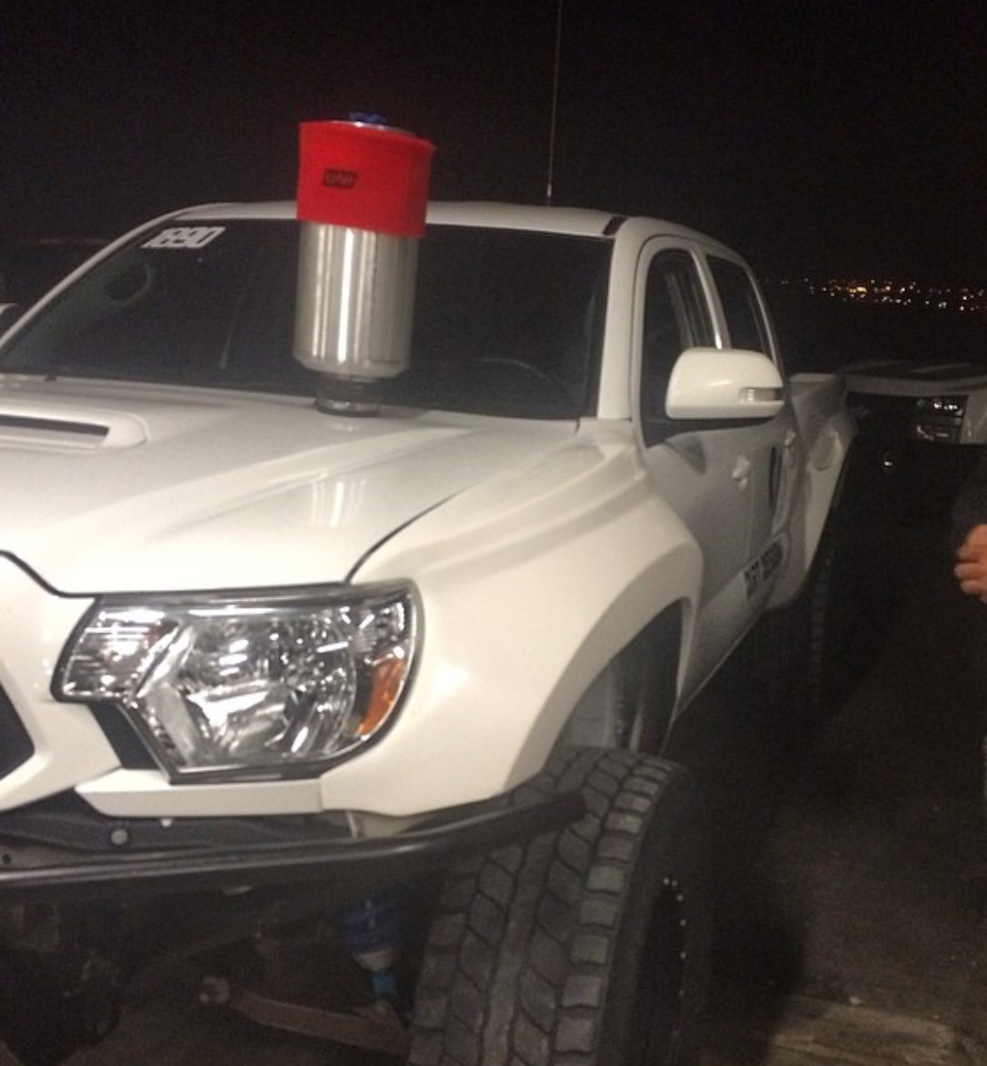

    Been working on this all weekend.. new intake kit for tacomas, slight hood modification required but worth it for clean air

    At least move it over to the passenger side
