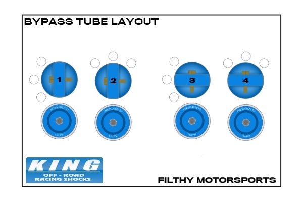

    You guys know best. Going to be ordering a 9 in housing soon and want to know if you can outboard 2.5 bypass shocks with 68 wms on a 1st gen without them rubbing the shock body. I'll cycle it once I get the axle but wanted to see if it was worth redoing my shock mounts. I know straight up and down is best but if I have to angle them do I angle them foward or back and how much of an angle?

    You should be good - guys rub 2.5 bypasses at full stuff with a first gen Tundra housing that's 66.5" wide wms to wms. Another 3/4 of an inch per side should help you stay off of them in almost all situations... that said the orientation of the tubes can help you stay off of them even more... @FlapJack935 is pretty familiar with this - he may run wheel spacers...

    If you put the tubes behind / in front (#2) of the shock rather than outside, obviously they'll rub less. You could always notch the frame and move them in a little since I'm guessing you'll be boxing it.
