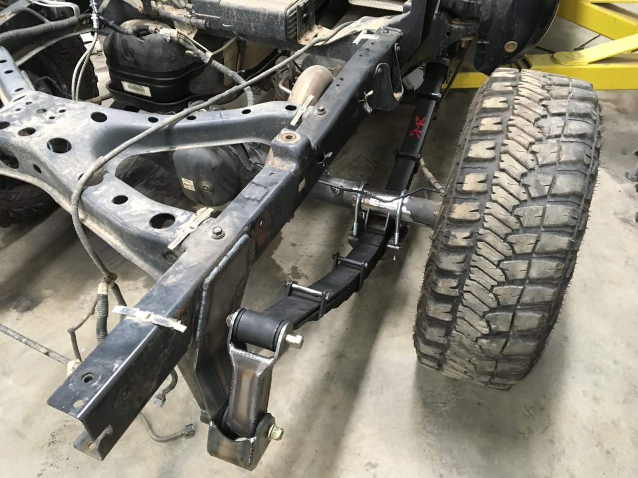

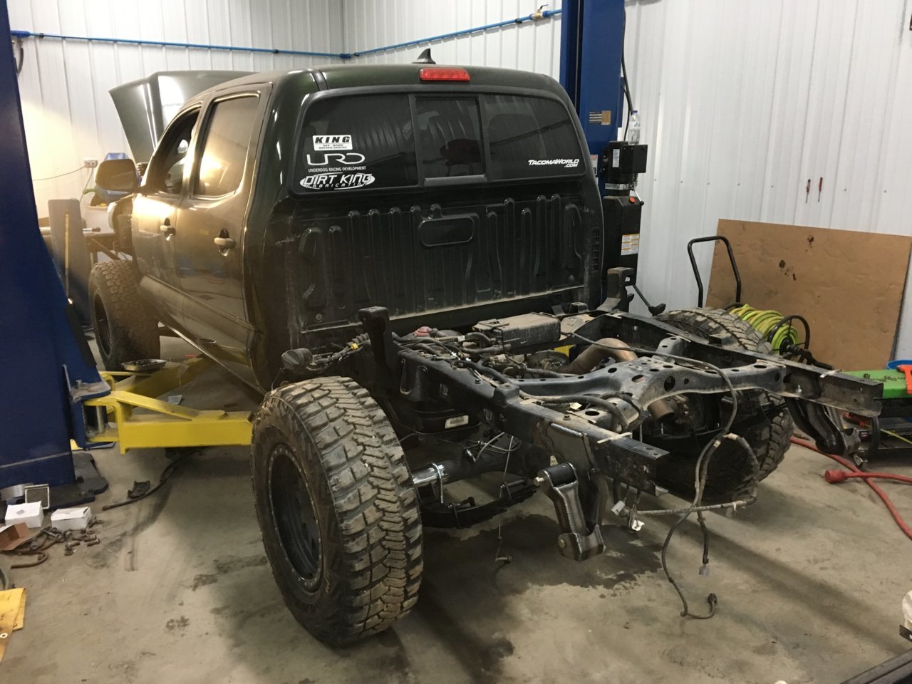

    Getting close to finishing her up now just haft but haft to wait another 2 weeks for shocks.

    Are those the shock towers you're using or are you going to build a bed cage?

    No those were from my mid travel kit and I just haven't cut them off yet. I bought the dmz bedcage that I'll be mounting in. I thought about building my own but It took me almost a year to finally finish my front bumper just because I get sick of working on projects that I haft to think to much on.

    Also does anyone have the pinion angle of the rear axle at ride height? I had it wrote down and now I lost the dam piece of paper.

    Want to say I shot for around 2* Obviously things change a little when springs settle, but that's that I did and have no driveline vibes at all. When I did it, I set the bed back on, set the bed cage in, spare tire at the back of the bed and through probably another 50lbs or so back there to get it to a more accurate ride ht before measuring and welding everything in
