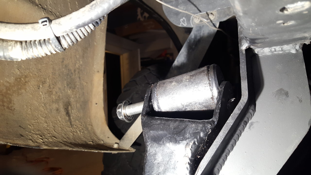

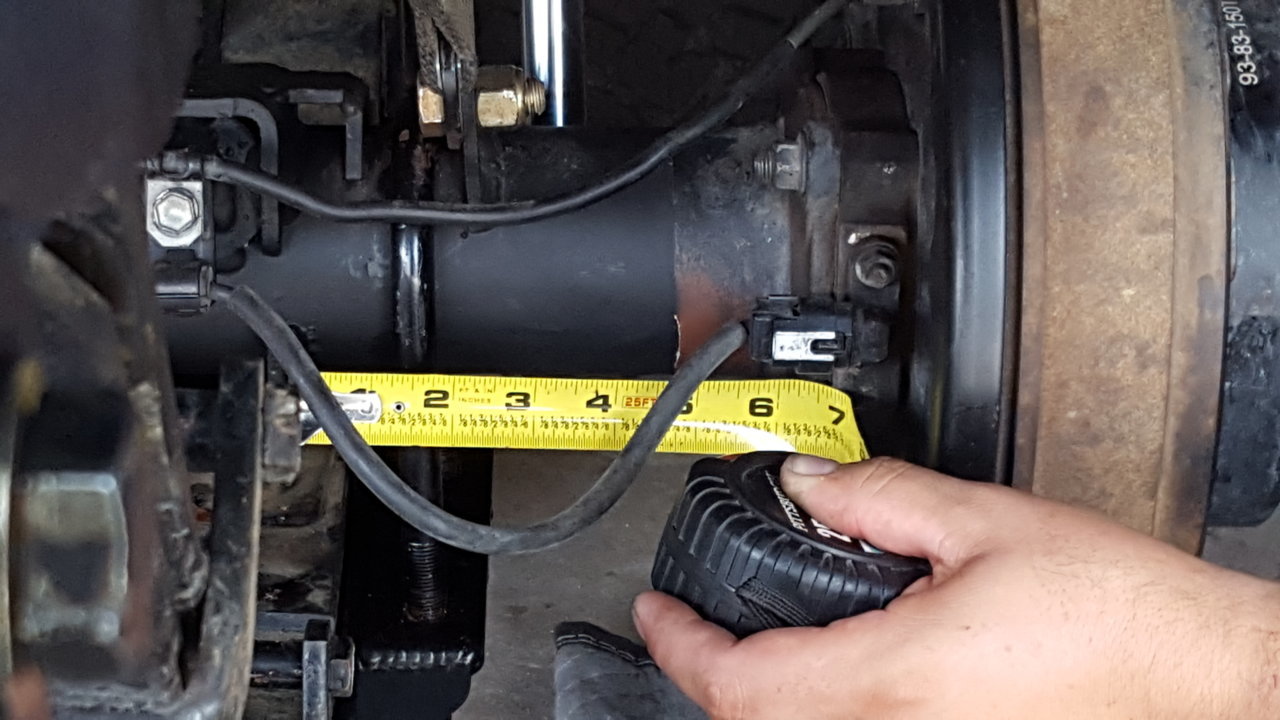

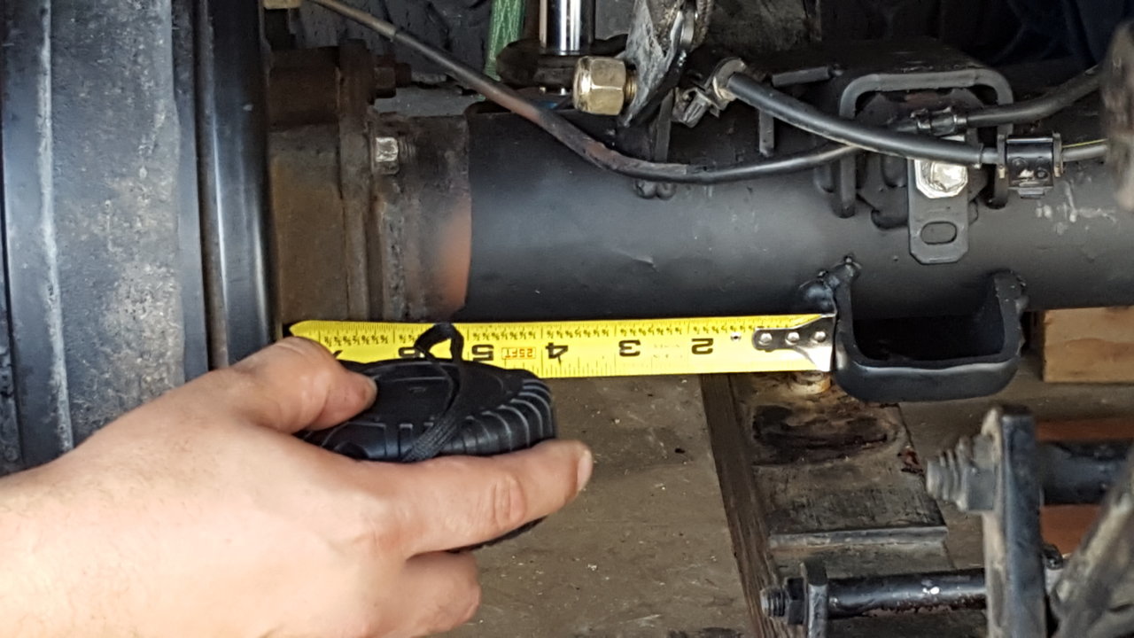

  12. Apr 7, 2018 at 8:17 PM
    Tbasch
    Tbasch Well-Known Member
    Oct 28, 2015
    #168007
    520
    Tanner
    Orange County, California/ Forth worth, Texas
    2008 DCSB Tacoma
    Try jacking the driver side up more, should line up, I had the same problem when I took it all apart.

  13. Apr 7, 2018 at 8:21 PM
    Dalandser
    Dalandser ¡Me Gustan Las Tacos-mas!
    Feb 19, 2015
    #149090
    17,630
    Anthony
    Downey
    08 PreRunner Regular Cab / 98 4x4 Extra Cab
    Empty Wallet Mod
    If the perches are where they should be, yeah a jack and ratchet straps will get you good.

  15. Apr 7, 2018 at 8:45 PM

  16. Apr 7, 2018 at 8:46 PM
    Rakso
    Rakso CeRaTi
    Feb 26, 2009
    #14105
    9,665
    OsKaR
    Cali
    09 PreRunner
    LSK LT in Progress, custom bed cage, DMZ SUA kit with 2.5 kings triple bypass, kings bump stops, baja bumper, rear custom tube bumper, glass all around, Weather Tech Liners, wet okole seat covers, Cluster LED Swap, HU LED Swap, hood LEDs, bed LEDs, etc etc etc
    So the question is, how the fack can I get that bolt off with minimum tear down?

  18. Apr 7, 2018 at 8:48 PM

  19. Apr 7, 2018 at 8:48 PM
    glorifiedwelder
    glorifiedwelder IG= @Liquid_Torch
    Feb 14, 2015
    #148647
    3,658
    jason
    Santa Clarita, ca
    double cab trd sport
    Minimum tear down? You need to clean those perches off that axle and weld new ones in the proper location

  20. Apr 7, 2018 at 8:50 PM
    Rakso
    Rakso CeRaTi
    Feb 26, 2009
    #14105
    9,665
    OsKaR
    Cali
    09 PreRunner
    Ok I understand that 100%.
    The question was more about how to take that bolt off with minimum bullshit, so I can drive it to your shop?
