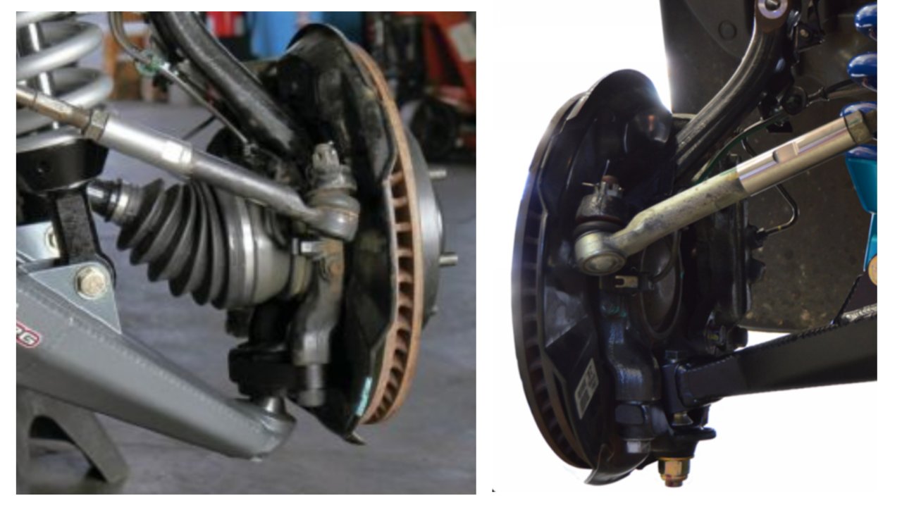

    5/8", I got a 4" bolt and it fit almost perfect. Except the Grade 8 bolt head doesn't fit into the uniball like the 12 point does. So i'll have to make sure to replace that asap
    Yeah. Will be upgrading someday for a larger kit with built in Uniball ;)

    Damn man talk about a hell of a bummer to deal with. I was under the impression that the burg kit had integrated uniballs on the LCAs like the TC race ones do? Either way man, def a wake up for everyone im sure.

    Was that from topping/bottoming out without properly setup bumps/straps? Or just fatigue?

    how will a kit with a built in uniball make any difference when you snapped the uniball bolt? :notsure:
    or am i misunderstanding and you broke the adapter bolt?

    the adapter bolt.
    looks oem. And if those are like 1st gen LBJ bolts..supposed to be a one time use bolt.

    Camburg uses that dumb adapter. I would assume possibly loose, maybe rusty and popped after enough pressure.

    Aye. I thought they had a uniball integrated set now a days, but that clears that up.

    but the broken bolt pictured is the 12pt uniball bolt. not the adaptor bolts.

    2nd gen adapter bolts are 12 pt, possibly F911 or that is an upgrade, I can't remember

    The bolt pictured (post 73661) that broke has a nut on it. The adapter that goes from that adapter to knuckle doesn't take a nut and is not in the picture above. It looks like the uniball to arm bolt is the one that broke.

    The adapter to knuckle bolt is an allen bolt.

    Was contemplating the differences in stresses myself...here are the two styles side by side. In both set ups the bolt goes through the uniball and a mis alignment so it really seems like a tomatoe - tomato difference ?
    The LBJ adapt that Camburg uses is really no different than the OE LBJ adapt it just replaces the OE one although it relocated over the LCA vs under.
    However one thing I just noticed ...anyone remember all of that Dirt King verbal abuse about using a small 1/4" spacer between the stock LBJ and the spindle for CV boot clearance on 4WD's and how some folks jumped all over how they thought it was dangerous and a bad design etc well...LO fkn L ...take a look at the size of spacer the Camburg ( and TC kits ) with the LBJ adapts use !
