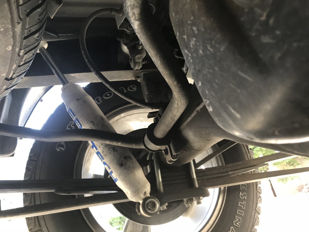

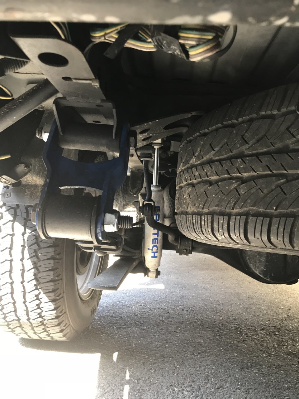

    How will i go about starting to convert my rear end into Lt with out having to cut into my bed

    you can't.
    Unless you do a link setup. Which is not an easy deal.

    I dont really need full on long travel, just more travel then stock to make the ride off road better.

    well you're not gonna pull more than stock due to the geometery of the stock length leaf packs and you're already SUA.
    You could relocate the shock either inboard vertically or go outside the frame with the TC kit or Solo kit. But you'll probably only get 10'' vertical. You could tune the shocks to make it ride great though. Would kick your stock front ends ass anyways.
    Wouldn't be really LT though..
    Not super familiar with 5 lug frame setups and if they are different though.

    could do a shock relocate and better springs. I don't know who makes it, but I've seen a kit for first gens that angles them differently in order to fit longer shocks under the bed

    I was also thinking of swapping to deaver 62 or something along those lines and staying sua. Just i dont want to cut into the bed, ive seen a few photos of guys with there shocks set up differently under the bed, and ive started looking into going out side the frame. Rn my rear end just beats me up and there isnt really any options for a 5lug so im looking to go custom.

    Im not too familiar with the first gen options, but I believe most travel gains require custom work for you guys.
