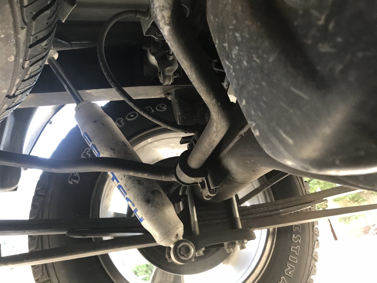

    Currently i get about 5” of up travel and thats with my tires kissing the fenders, im sure with fiberglass bed sides the rubbing will be eliminated. But im looking to increase up travel and put the rear end about the same hight as a stock pre runner or 1-2” taller. So i can fit bigger,better shocks so i can smooth out the ride some
    Edit: im also touching my bumpstops in the rear which stops the up travel.

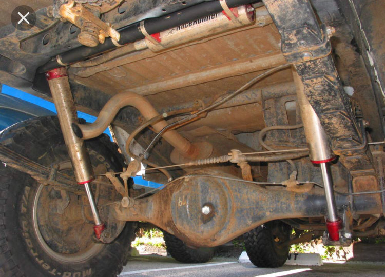

    Ive seen a few photos like this of guys just relocating there shocks under the bed in a different position. How well does that work?? Of course i would do sua vs his soa.

    Ive done that too. If you check my build thread I did that exact setup with 12" short body bilstiens and bumpstops with deaver bolt in leaf pack j59 and it worked really well. It was super fun offroading. Honestly this is your best bet if you don't plan on going super crazy. But still able to do lots of fun stuff.

    Oh and I would just keep it SOA . No reason to sua if you your gonna keep shocks that small under bed. IF you SUA you should REALLY just go through bed with 16" shocks.
