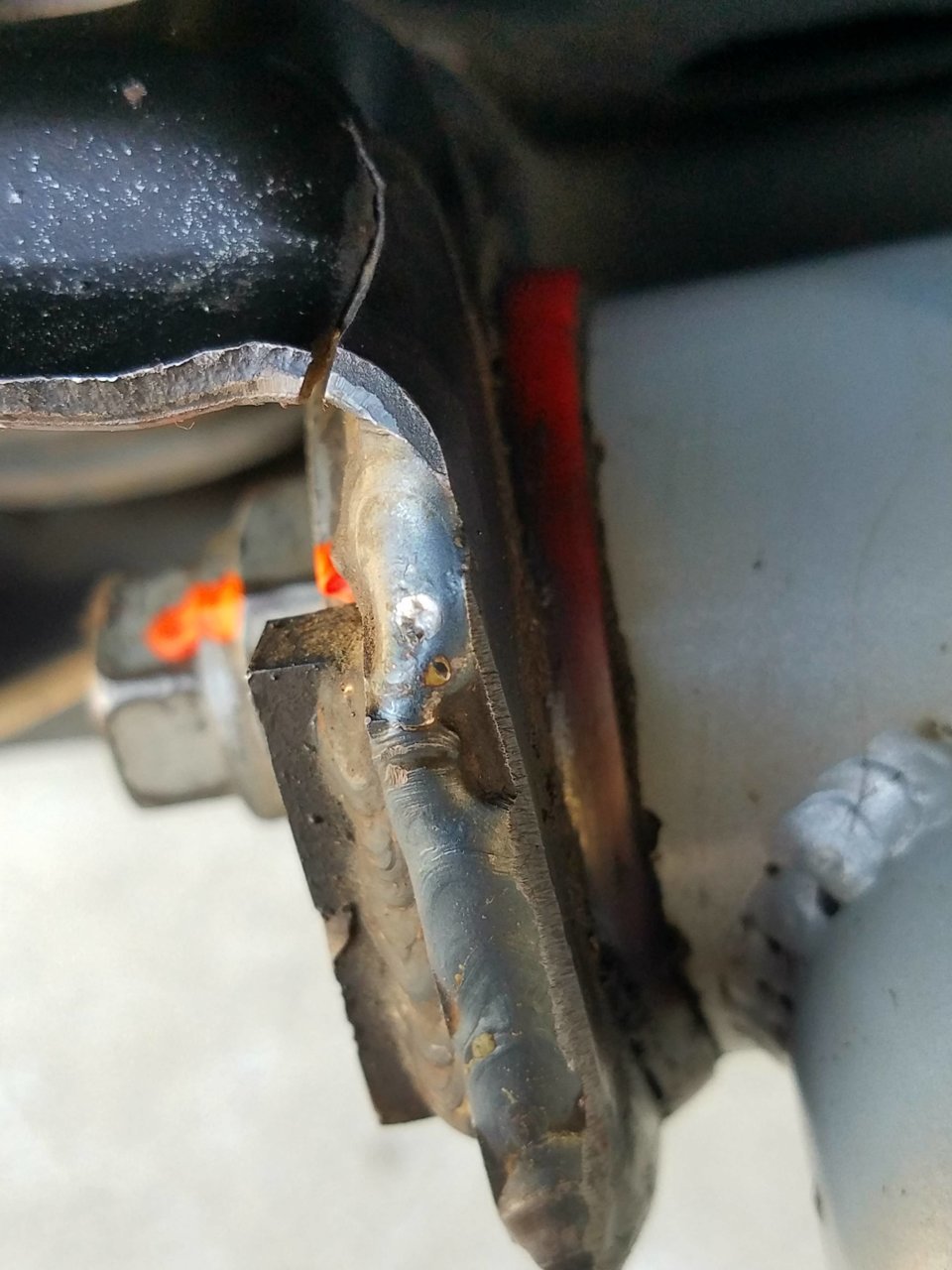

    The mounts started to separate 9 years, a bead was laid down on each side as a fix. Lasted that long until very recently.

    Tom, make sure you drill a tiny hole at the end of the cracks , that stops it from continuning from cracking.

    I swear, half my tacoma is filled with tiny holes...

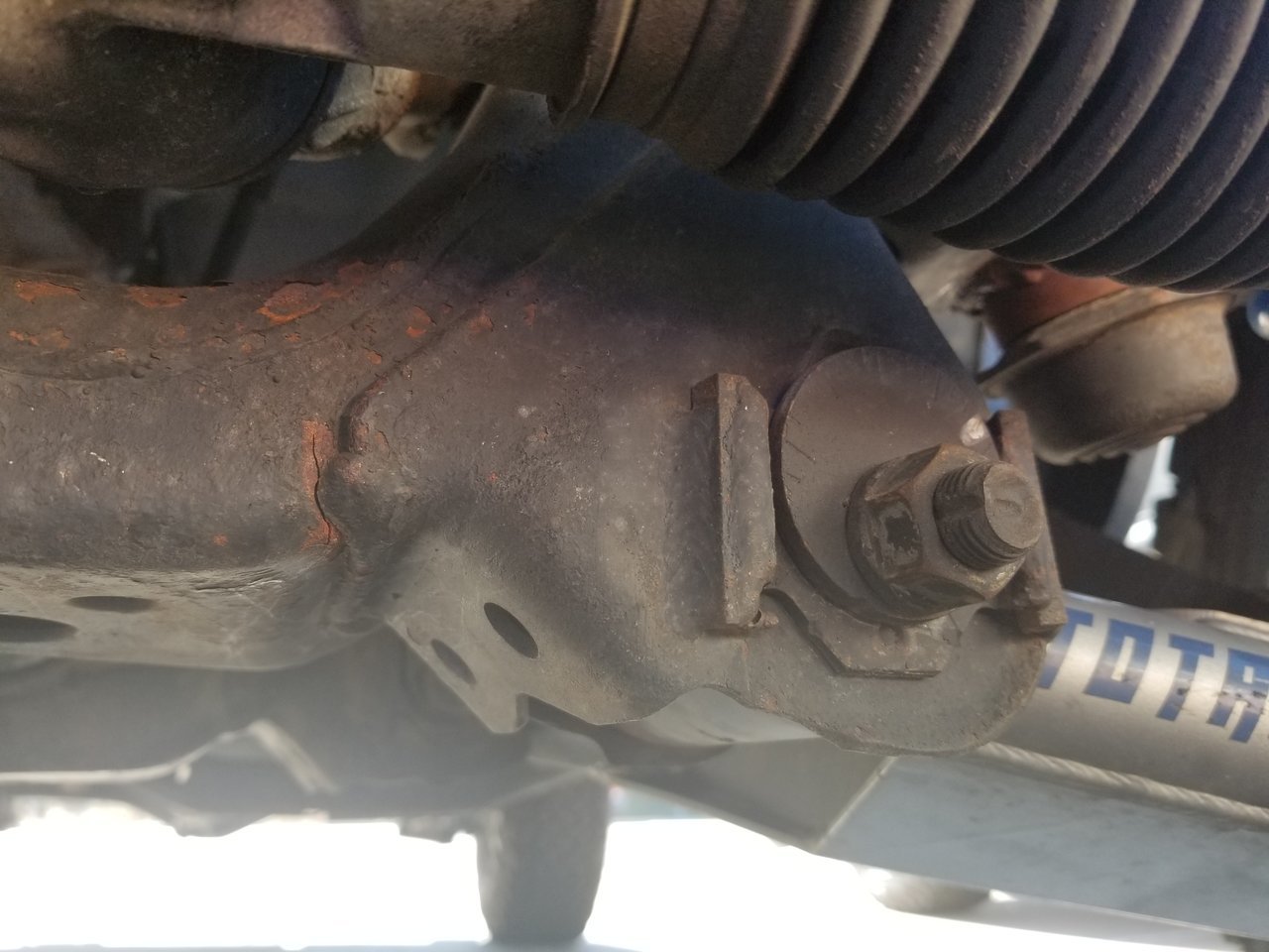

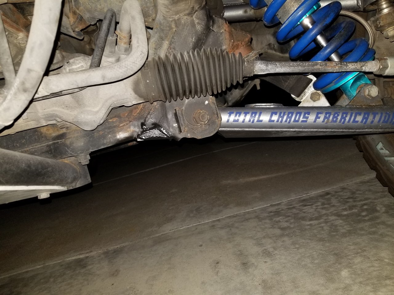

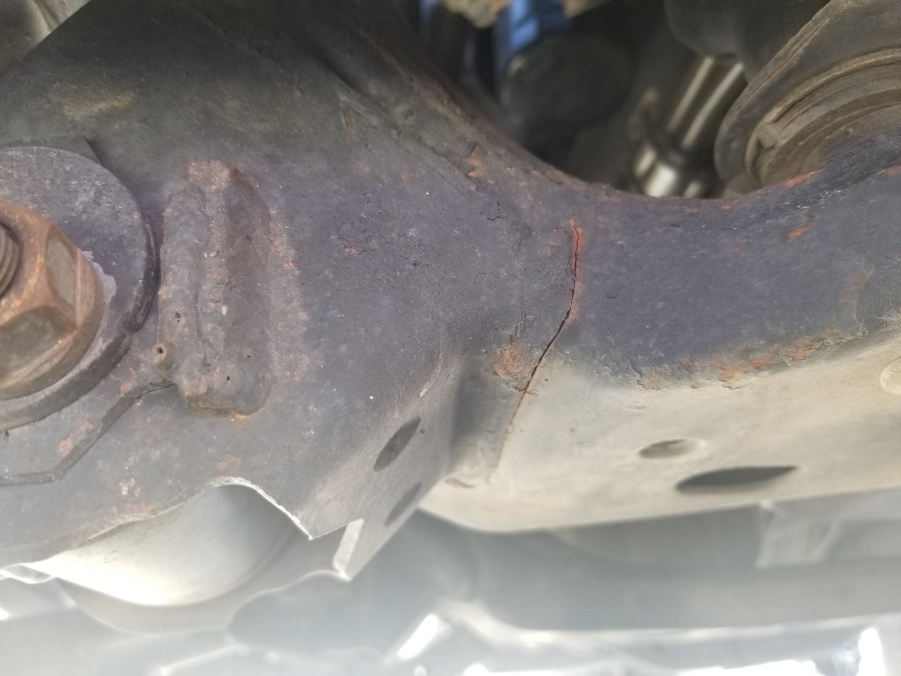

    I'm guessing I should probably do that as well? Found this gem over the weekend. Thinking on beveling the bottom, welding, grinding, and plating. For the side I'm not too sure, maybe drill, bevel and weld? It's the notch on the chassis I made to clear 3.0s.
    Edit: The photo doesn't do justice but the side has a crack running all the way to the top of the chassis.

    ouch. That sucks.
    Looks like you've tried repairing it before too but the welder wasn't on hot enough by the looks of it.
    Plate the crap out of it.
