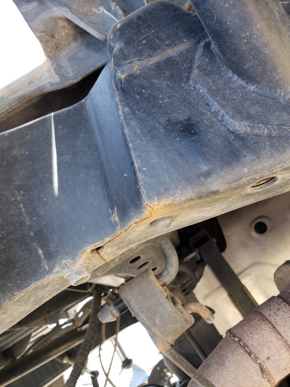

    Are you guys drills the ends of the cracks or just welding over the cracks?
    It seems like on these trucks once you develop cracks the heat cycle on the weld repair tends to lead towards the metal cracking again right at the weld.

    If I can reach the spot with tools, I like to drill the end. Grind a slight groove into the crack. Weld over. Grind weld flat. Plate with 1/8 over.

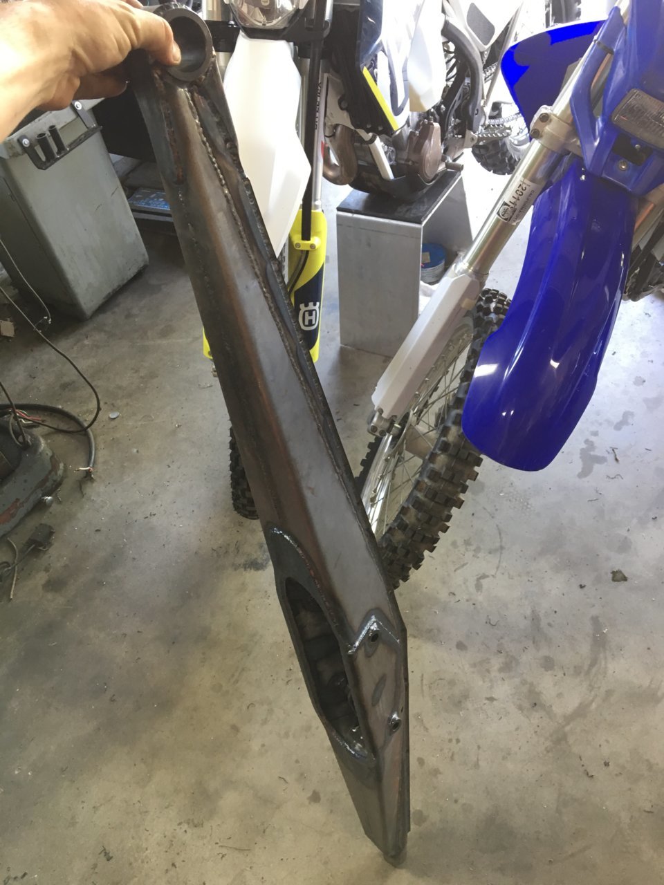

    I’m really over welding these things... and I still have one more to do... just a side note...if you design sumthing... make it so you have minimal welding lol

    Yes trace the cracks and drill a hole at the end. And grind a groove in the cracks and weld.

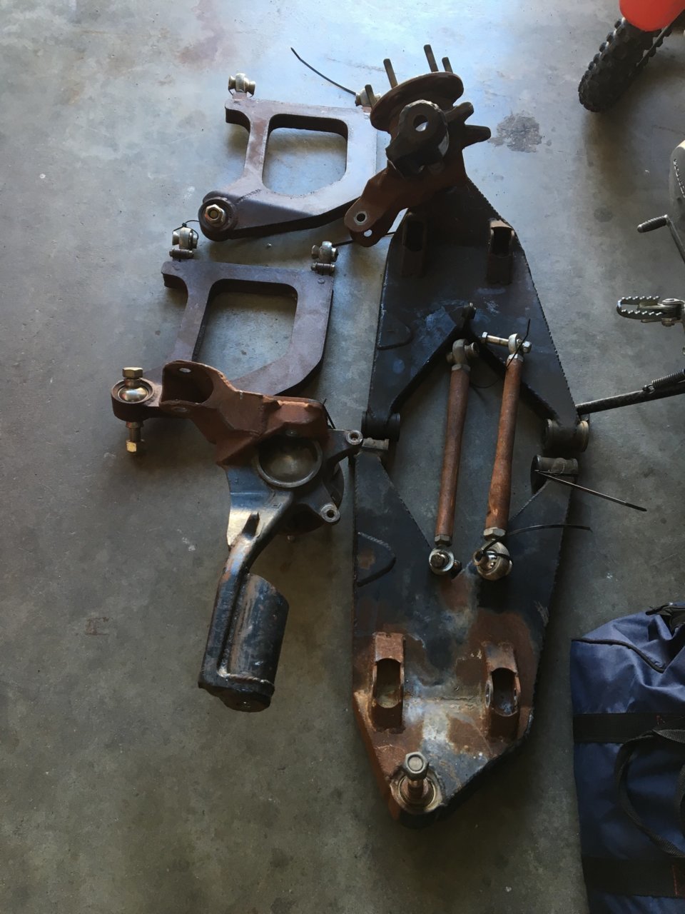

    Ok. 1500 and come with extra parts.... super good deal haha. Gonna keep the whole kit together sorry

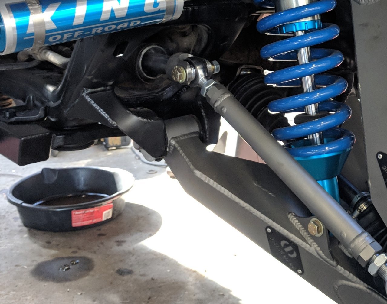

    :benchpress: new shocks baby !!!!!
