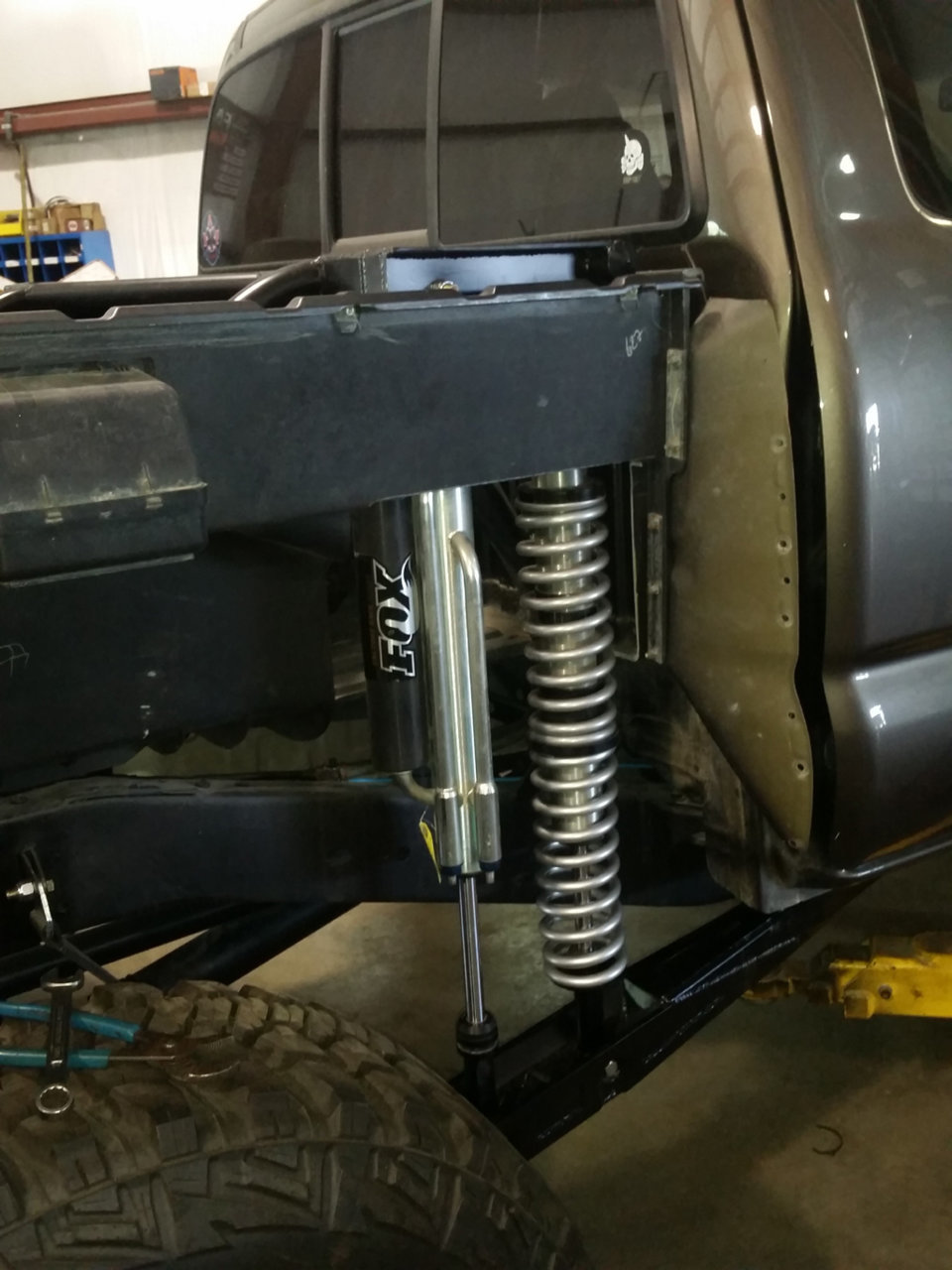

    hey with the new bypass shock should i do remote reservoir to my bed cage or run piggie back reservoir (bed cage made to run the reservoir)

    Running remote will give you more room for sure

    I'll say the opposite. Piggyback. Most rear I'll see the bypasses set up as piggyback. You would need to run a pretty long hose if you do remote because the resi is near the center of the body instead of the end cap. Assuming you have enough room for piggyback.

    If you have the room, I'd say piggyback. Saves room, don't have to worry about fraying the hose, and leaves them out of sight from prying eyes. I have remote reservoir but run them under the tube to try and leave them a bit out of sight.

    Piggyback, was easier to cut a larger hole in the bed than try to find another location to run a remote reservoir IMHO

    how big of a whole do i think i need for the bypass about 8" long ?

    If you decide on remote resi, make sure you get bottom mount resi's, fox makes bypasses with the resi out the top cap, don't want that on a bypass to really use the bump zone.
    I think piggy back resi's cool oil better than remote.
