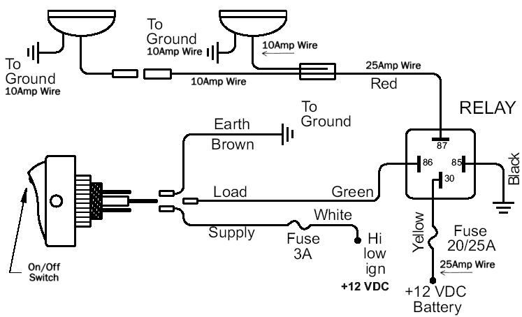

    Looks like your switch is simple battery plus accessory wire. You need to figure out what wire is what first
    It’s likely that black is ground btw
    Also if you tried every way then something is wrong

    study some wiring diagrams. One wire from ditch lights to switch. One wire fused from battery to switch and done
    I personally used relays though for my lights
    With auto red=hot
    Did you not wire the other end of the harness yet ?

    Maybe refer to the diagram that came with the lights
    One wire will be for the relay trigger and one is power to the switch
    I’m betting the relay is wired incorrectly

    21C998AE-1860-4347-A7A1-57C6C9461146.jpg 2AD07337-5F71-40FA-991E-BF068E7BE69E.gif
