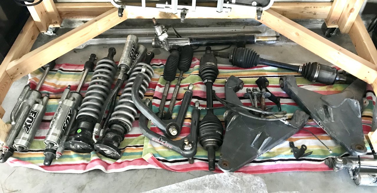

    FYSA Selling the 05-15 4x4 Camburg kit that just came off my truck. Bought it in ‘16, about 10,000 miles on the kit. Heim Uppers, 4x4 axles, Fox coilovers and triple bypasses, oem steering rack, gusseted spindles, TRD Sport Stock 8.4 read end all for sale. Hit me up via PM for price. More pics in my build thread and the long travel classifieds thread

    @jeff b get this !!!!!!! and sell you'r old stuff
