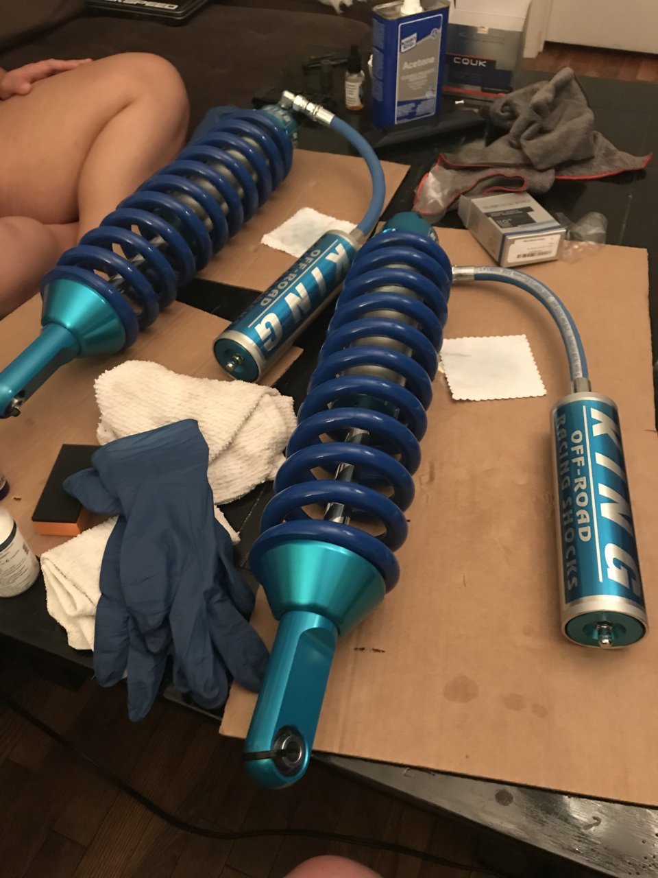

    I wish this one was mine! I saw the pictures and mine was a 2.5 double bypass with piggyback, and thats a triple with remote resi. Damn I wish that was mine though- good looking out!!! We will find this guy (hopefully)

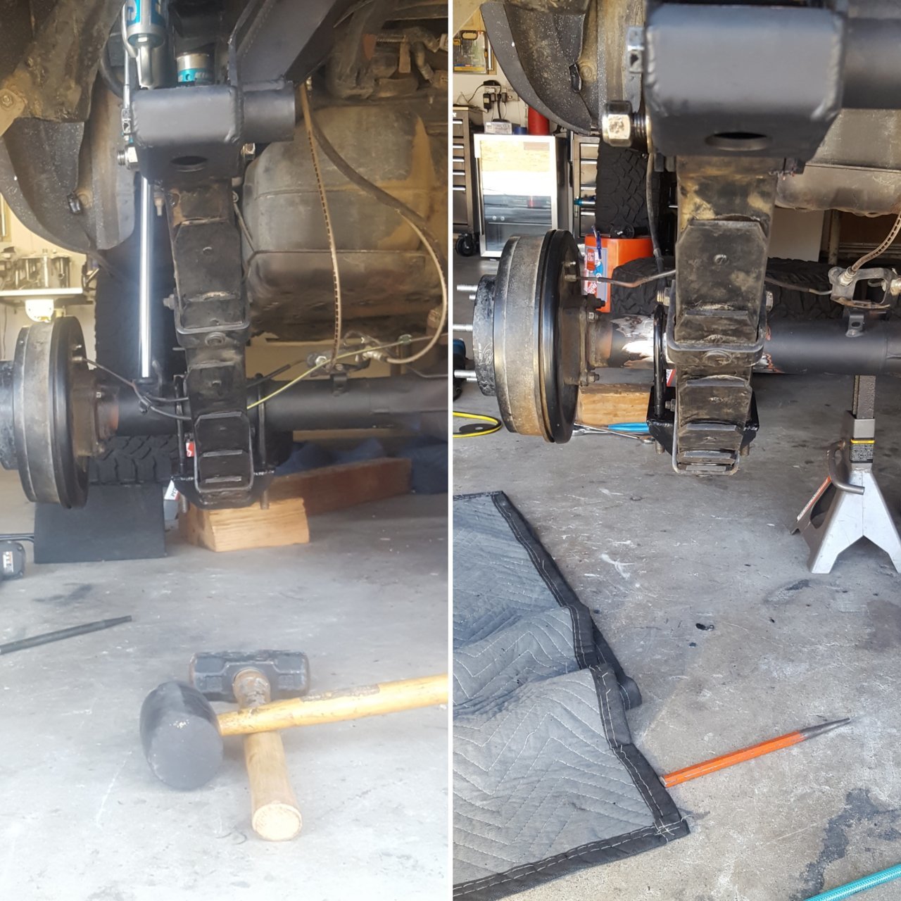

    Before/after driver
    Before/after passenger
    5 3/4" even measurements on both sides. Pinion angle next.

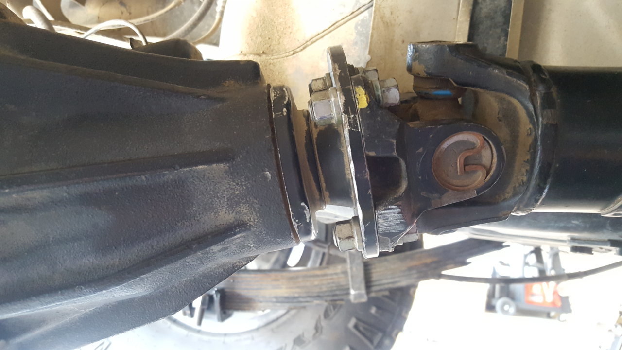

    How is this for 5.6°?

    That looks a bit too far. Should match your transmission output angle but just a degree or 2 lower

    I think I went to low this time
