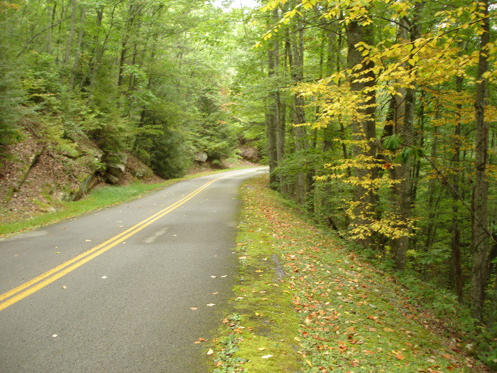

    Looks like the back roads out here in VA, MD, WV. No damn shoulders.

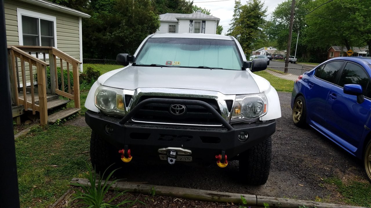

    Hey all. I've been working on fitting my Advanced Fiberglass Concepts fenders (from last years gb) the last couple of weekends. I'm hoping to get it done this weekend. I've got a few spots to clearance that are still touching up by the a pillars and around the headlights. The headlights are giving me the most issues. The upper mounting arm that attached to the stock fender sits on top of the fiberglass, but there isn't enough material there to actually attach it to the fender. The extra thickness of the fiberglass compared to the sheet metal fender is causing the headlight to sit at a slight angle and hit the grill at the top of the blinker reflector. I'm thinking about either clearancing the fiberglass so the arm doesn't make contact or adding a washer under the two mounting points nearest the grill to level it out. What did you all do in the headlight area to get it right? I can get other pictures if needed.
