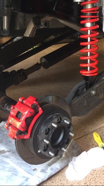

    yeah, i cant complain too much i guess. $1500 included coilovers. just had to get axles, new upper uniballs, and tie rod extensions.

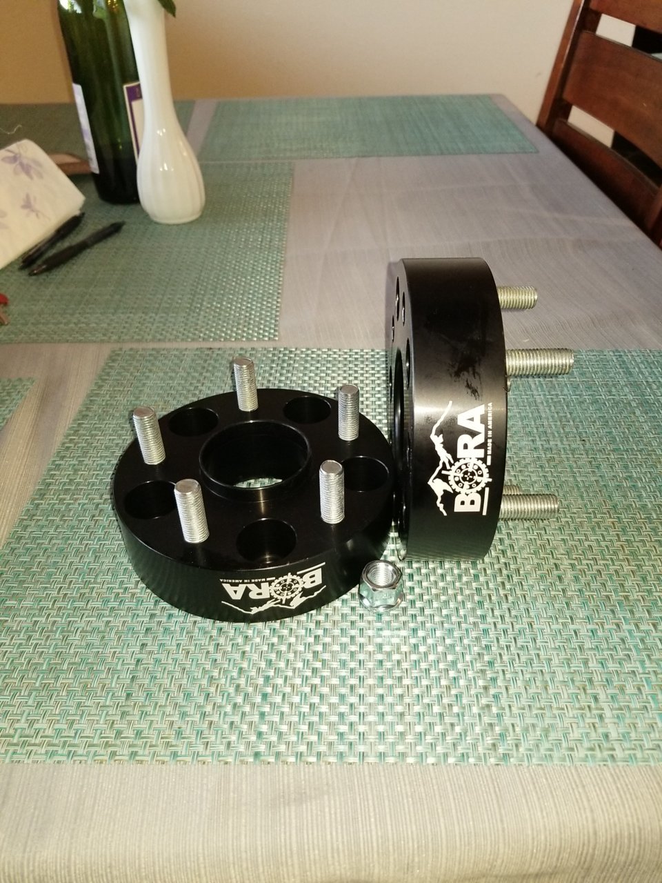

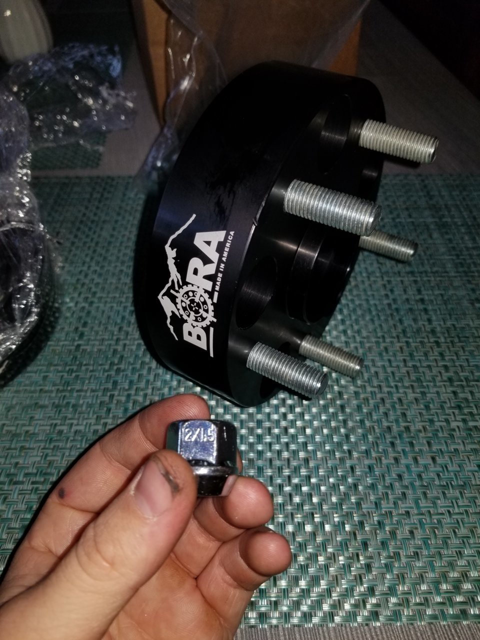

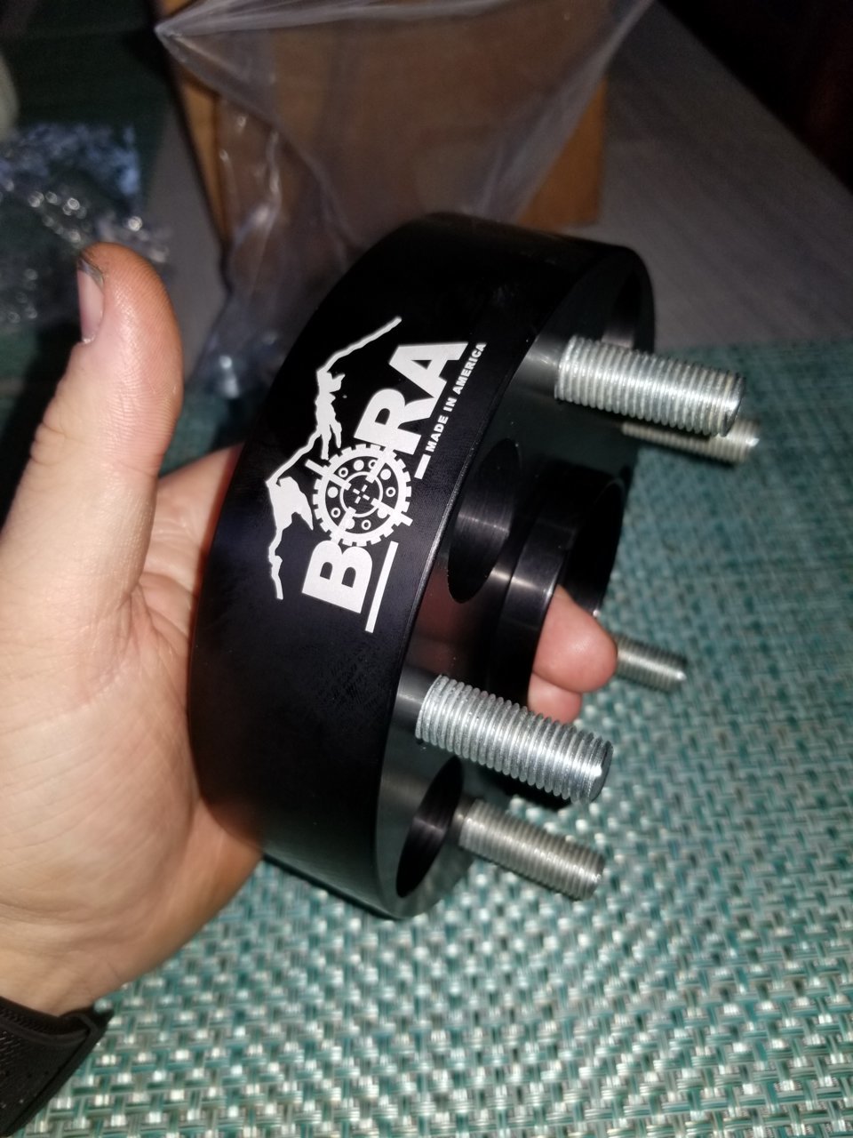

    hell ya they showed up only waited about 3 weeks :D
    so fair as install it just says clean off the hub and but wheel spacers tight to oem spec
    question did you guy use any lock-tight or wheel anti seize just wondering and would like some input
    and would you get new nut for more thread engagement?

    allpro has the longer ones

    Definitely lock tight, blue if you want it serviceable, red if you want to bang your head against a wall and cut them off with a blow torch later. Those acorn nuts work fine on mine, pleanty of thread engagement. Yes, OE torque and don't forget to re check them in a couple hundo miles.

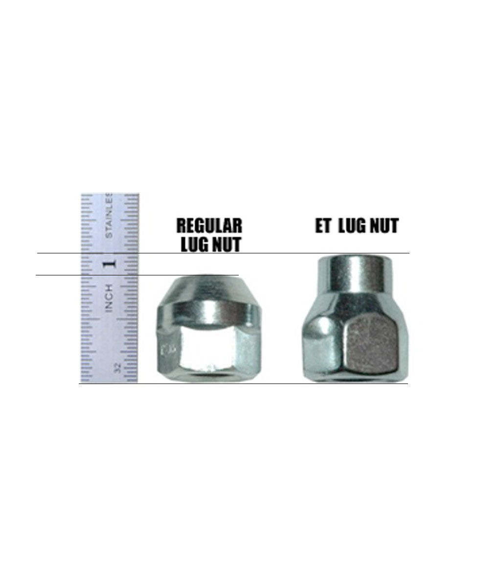

    on my spacers an ET would not work, it would bottom out before it was actually tight on the stud... the spacer has a conical seat.

    any pic of your spacers?

    ya i was thinking the same thing
