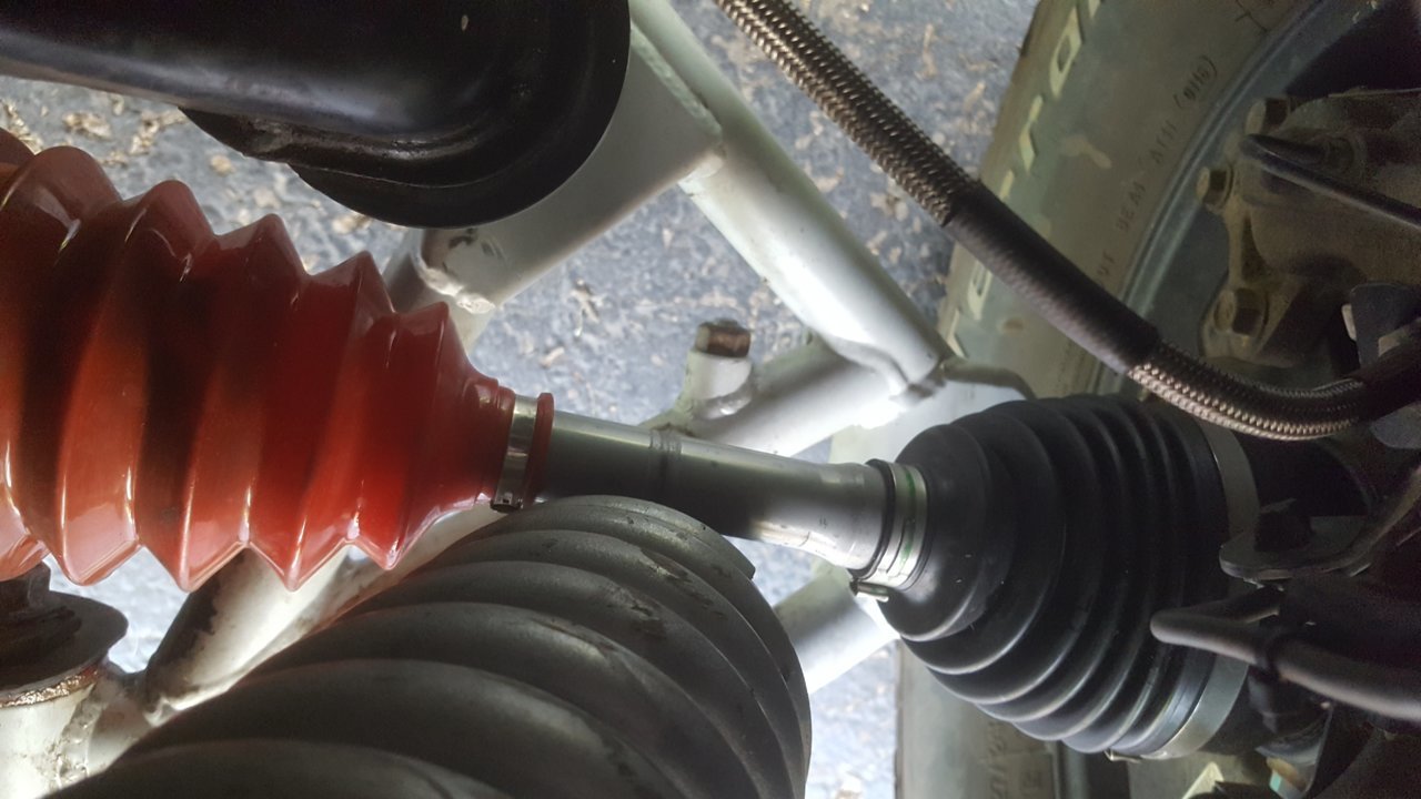

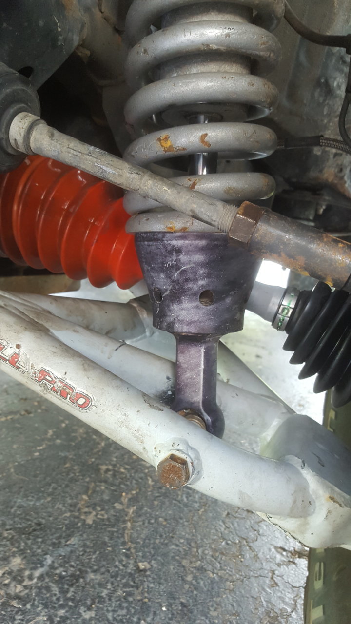

    :laugh: everyone knows its true but itll still be an upgrade from a "MT setup".
    i believe it was a totaled truck from the rear? i picked it up from a buddy who originally bought it.
    i did run into an issue though with the axle&shock rubbing. the bottom eyelet is too short.
    can someone tell me what the extended length on 8inch shocks should be? my shafts had like 5 5/8 showing at droop? either need to figure out if i can change the lower eyelet or order new coilovers

    I don't know what specs the All Pro specific shocks had but you could try flip the half moon retainers that the lower spring seat sits on at the rod end and space the seat up a little bit and see if that clears.
    That looks like how they are setup on the last pic you posted.
    Check with All Pro on the coilover specs.
    If they are the right ones and still rub and you have access to a lathe you could setup the lower misalignments to space the lower rod end forward a little in its mount if it will still clear the steering.

    id rather figure it out myself then deal with them. after not having simple items (which were missing from an order originally anyways) ship for 3 months they can screw off.
    ill take a glance at spacing it forward in the mount. i believe there was room to clear.
