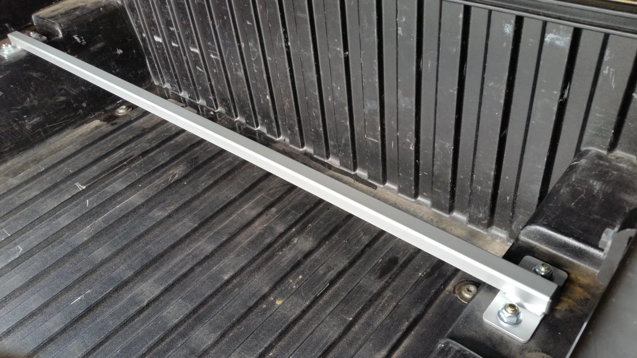

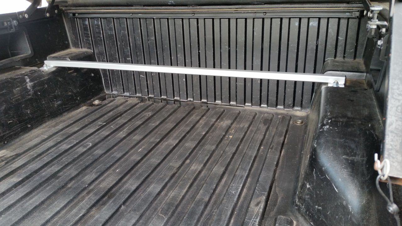

    I don't believe this is accurate, the Archive relocation towers bolt to the bed at the top and allow installation of a cross brace. Without this, it doesn't matter how strong the tower is, the crossmember in the frame is weak and allows the frame rails to rotate. Allowing movement might inhibit the shocks from doing their job, and contribute to a chattering or twitching feeling in the truck.
    @BEAR_KNIFE_FIGHT The Archive kit comes welded up, ready to install, and gives you more options including some bypass fitment. You get what you pay for. Compared to Total Choas kit at $695, that fits 10" bypass and has a small contact with the frame rails, the Archive kit delivers.
    Also, if there is question about the strength of formed sheet metal, the Archive relocation towers are able to deal with plenty of side load without deflecting
    Eric

    Cool man, solid info. By cross-brace do you mean at the top of the towers in the bed, or at the bottom where the frame is? I'm not likely to cut holes in my bed for a cross-brace to try to keep the bed sealed a bit.
    I'm still trying to get a good plan for what I'm going to do regarding shocks -- 2.0/2.5, clickers, bypasses, etc.
    Thanks for the pictures and info!
  19. May 29, 2018 at 8:31 PM
    ARCHIVE
    ARCHIVE Well-Known Member Vendor
    Oct 29, 2015
    #168099
    2,253
    Eric
    Orchard Park, NY (Buffalo)
    '05 Taco, '22 Tundra, '91 Cummins
    2.5" Fox relocation * Hammer hanger * Archive MD springs
    At the top of the towers, 2 bolt holes in the bed each side
